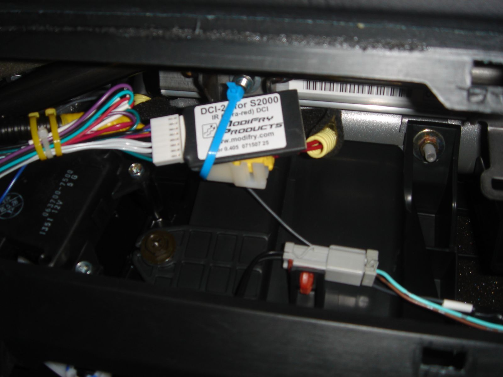

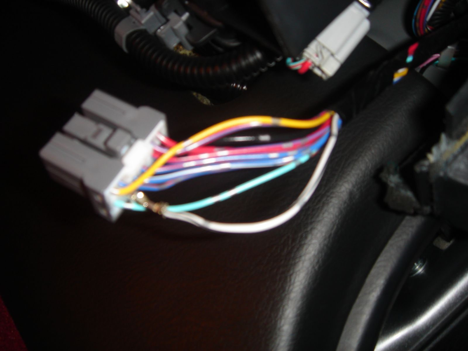

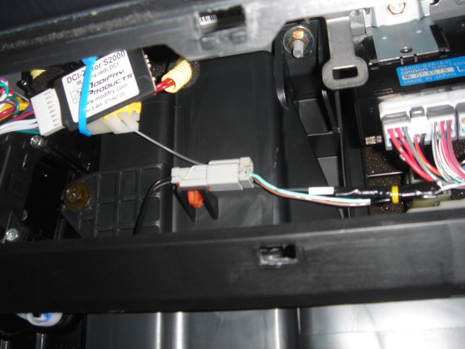

Let me start off a few pictures under that dash I did to mine monrhs ago. Hope this help
this is an 05'
this is the plug with the speed wire pulled
Use a tiny flat head screw driver, I go from inside the plug try to pick the plastic lock against the terminal then pulled the wire on the other side at the same time.
this is where th plug pulled off the module hanging loose below
Modifry module with grey wire run to the speed sensor wire
Below is my Ipod control unit module place on top of convertible top module due to not having much room behind radio (Yellow, black, white wires)
Good luck any more question you can PM me, I'm gald to help.
