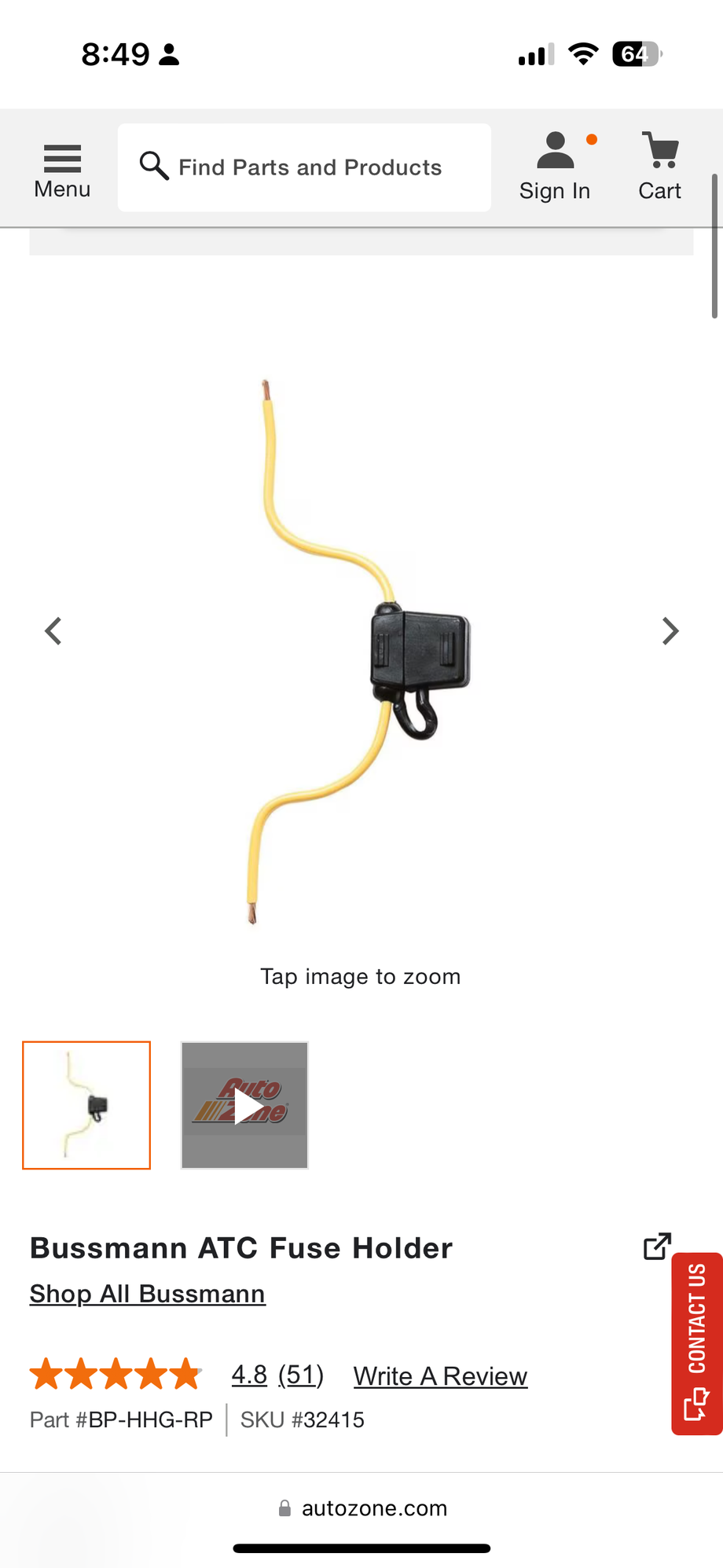

So one of these before connecting will protect it ? I think the only reason the “always on” needs to be connected is for the date on the camera

Yes. You need one of those for both taps. The always on is probably a very low current just to maintain memory. So guessing like a 1A fuse would be enough.
