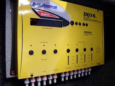

On Thursday, I had the pre-outs going through an AudioControl DQXS Digital Eq/Crossover. According to the DQXS manual, I should turn up the headunit 3/4 volume, and adjust the input signal until the input LEDS maximize on the transient peaks. My 9857 can not light the LEDS, even at full volume. AudioControl says that if this happens, you may want to purchase a line driver to boost the signal. They say that many manufacturers have (engineering specs and marketing specs).
So I had my gains up much further than I would have with a 1994 Alpine. I am guessing that I was feeding it a clipped signal.
