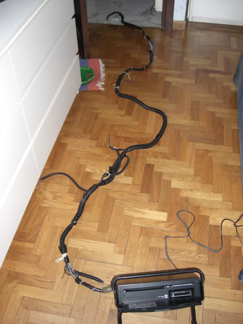

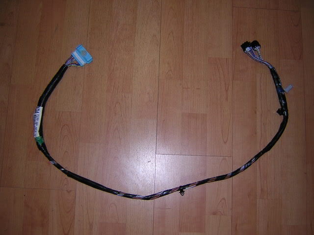

Today have opened the package was sent to me from Yuki Japanparts and I have see this:
incredible...
For connect the monitor i must use that huge harness...
The harness have the connector for the cluster, and the radio and the radio Aux, probabily for hear the navigation voice..
and the dvd harness it's the same.. huge..
I think to use the ODYSSEY dvd harness and unit, it's very simply to connect..
But remain the monitor problem...

Odyssey wire harness

Old Jul 15, 2007 | 05:42 PM
