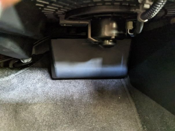

After a while of researching subs for the car I ended up going with the Pioneer footwell sub and am pretty happy on how it turned out.
I too was just looking for some bass to fill in the bottom end and lighten the load on the door speakers, nothing window shaking. I was able to mount the sub up under the dash, bolted to the two studs that support the heater box. I had to design and 3D print the brackets since I didn't want to screw or cut anything into the car (happy to share the STL).
View from the passenger seat
Sub mounted under the heater box/dash
My fallback if I couldn't mount it under the dash would have been to mount it under the drivers seat like others who have the Pioneer or Kenwood under seat subs. Since the footwell sub is the same height but shorter in length and width I suspect it would fit without problems and could be totally hidden.
