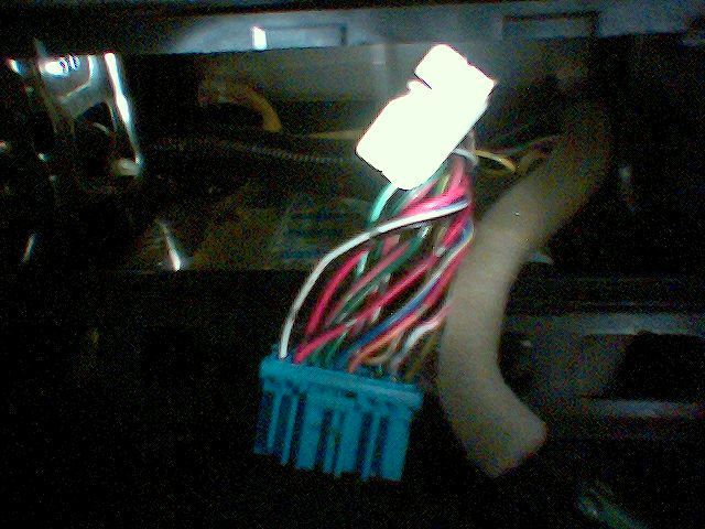

just got a pioneer (deh-p80mp)
i got a wire harness from circuit city for it but it will not work with it. it looks i will have to hard wire it.
does anyone have pics or diagrams of this done?
plus when i took the radio apart i noticed that there is the normal radio harness(light blue) and a white one. what is the wihte one for? the pioneer does not have an out let for the white harness.
i have a honda manual and the "white" harness is not mentioned in the book".
pic of stock harness

circuit city uses universal harnesses.
we sell the pioneer side for like another 17 bucks
just cut off the 2x10 pin whitish/clear harness and match up the wires.
soilder or crimp and your good to go.

what do i match this harness to? do i match it to the blue one?

This might help. It's a picture of a "stereo adapter", which is commonly used to plug into the car's factory harness (the blue connector) and provide wires to splice into your HU harness. The wire colors shown below are industry-standard and PROBABLY match the color of your head unit wires (most HU manufacturers follow this standard, but check to be sure).
The "Honda colors" in the drawing are the corresponding wire colors in the S2000 factory radio harness. You can use this to match up the wires that need to be spliced, but if I were you I'd go spend the $15-$20 and buy an adapter.

The white plug is not needed. I would guess that it is there to make wiring in the CD changer and/or XM easier.
