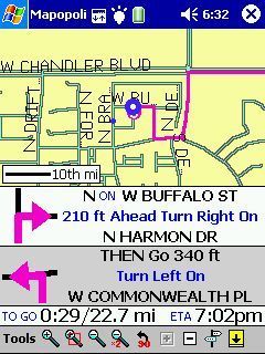

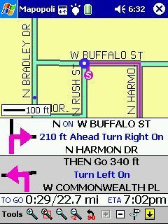

BTW, photos of how Axim was installed inside the S and screen shot of Holux/Mapopolis in action is very helpful!

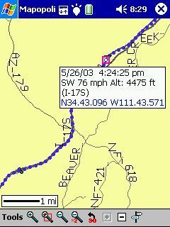

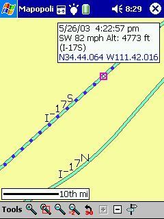

What's cool about the new version of Mapopolis (4.11) is that you have a GPS log. I drove up to Flagstaff this weekend and here are some screen shots. Each dot represents a clickable history of the information. It records second by second a lot of information up to 256Kb (I started at 7:45AM and got home at 7PM and the log was still recording). There is also a readable log you can scroll to review. You can even play it back to watch where you drove.
