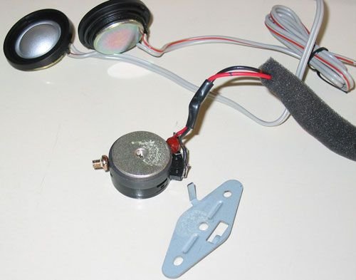

On the top left are two of the polk tweeters. With all of the black surrounds, they are slightly too large to fit in the stock housing. The down facing tweeter on the bottom is the stock unit. It has a hole drilled in it for a screw and the clamp is right beside it.
Questions:
1) How do i remove that cladding on the polk tweeters so they fit?
2) Once the cladding is removed, how do i secure it to the bracket/clamp designed for the stock unit?
These were supposed to be "drop-in" speakers but they obviously aren't.

I installed the same components into my '02 stock pods by slightly shaving the inside of the posts to let the tweeters slide in. I also had to cut two notches out of each tweeter's black plastic to help (this has a benefit of keeping the tweeters from spinning). Then I crimped/cut the extra tongue off the metal bracket you included in your picture and re-mounted the bracket to the stock pod posts. The bracket will hold the tweeters in place.
Be careful not to shave too much off the posts.
