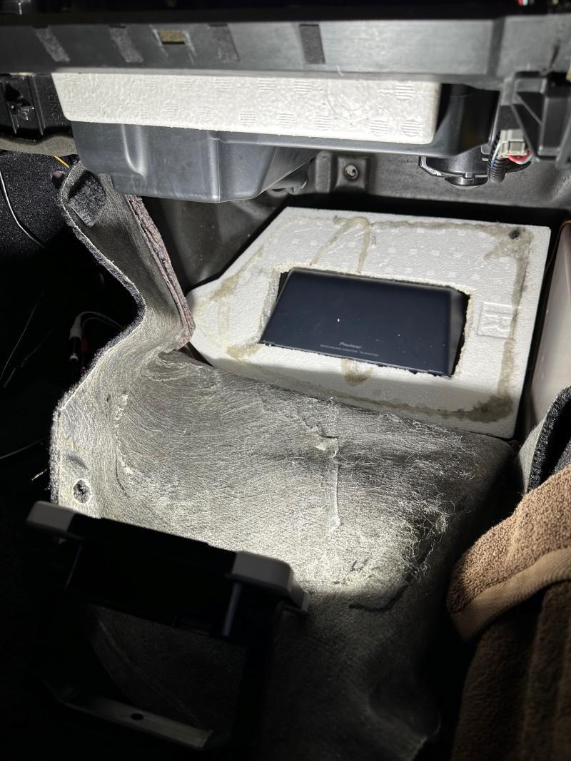

Thanks for your post a few months ago about that newer one! Here is the newer gen installed. You just have to cut out the foam to shape (I wish i took more time precisely cutting but it fits really close to flush and sounds fantastic after the break-in period. At the time in January, it was cheaper to buy from Japan on ebay than any US retailer. Not sure if that's still the same story but love mine.

Wow, nice!
Did you remove the white foam wedge to cut it?
Did you also carve out the thick pad under the foam wedge? Its about an inch thick.
Yep I had to cut into the thick black foam pad below as well.
