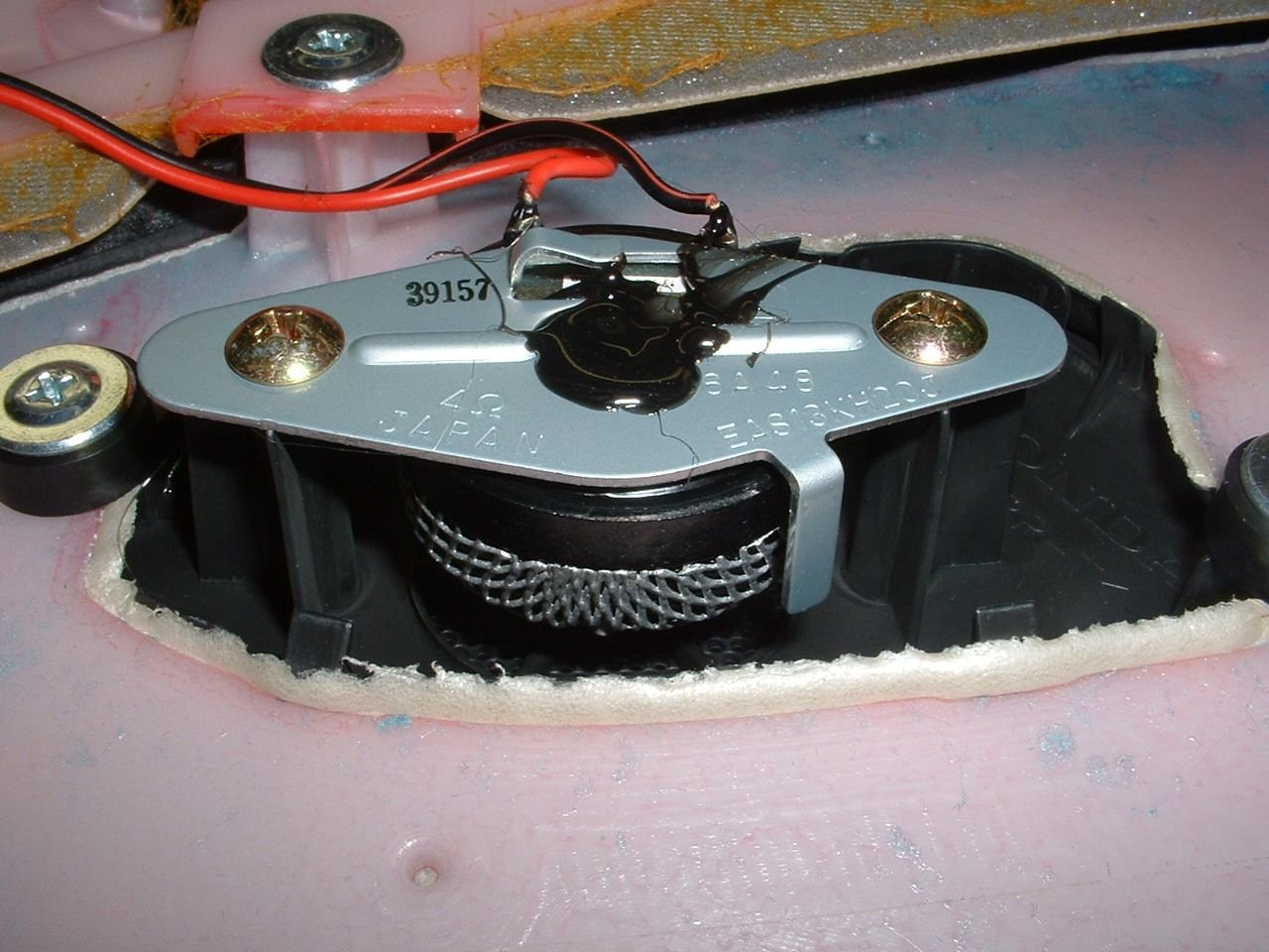

The 05's are really not that much different than the previous models. Attached below is how I did a recent customers car at our shop, we used Infinity Kappa's. Use the metal bracket that already has the factory tweeter mounted to it. Take out the screw holding the tweeter in, and pry it off the bracket. Then Hot glue or epoxy the new tweeter onto the bracket. Double stick tape will eventually fail on you, so Hot glue is the best because you can remove it and reinstall the factory system if you want later.
Good Luck.
