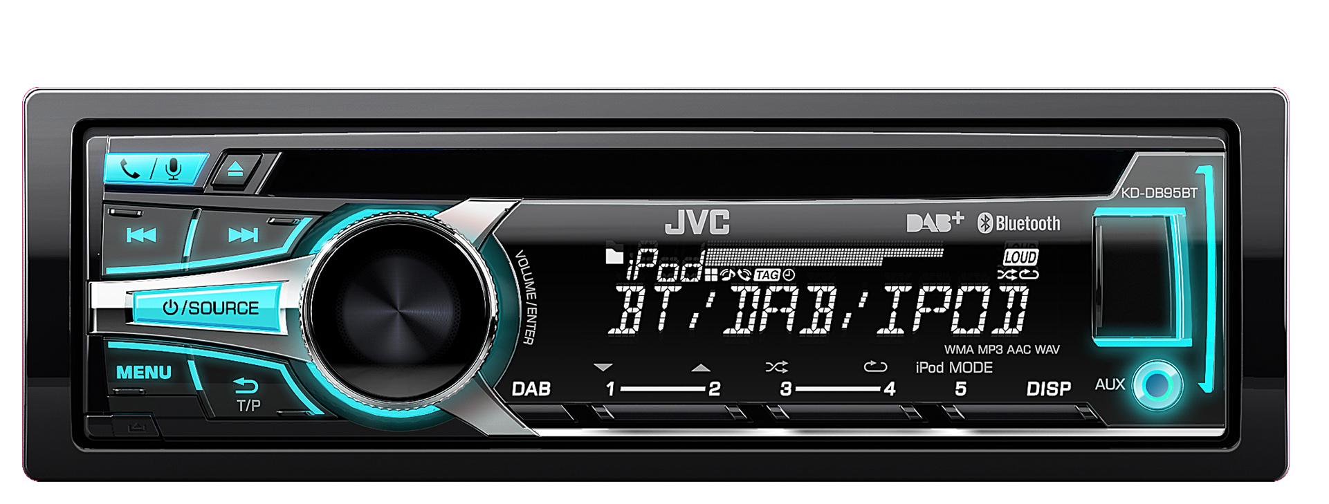

Originally Posted by ukhanspam@gmail.com
1) Could I close the factory radio cover if I install these units?
This is the problem that I am having with the JVC KD-DB95BT DAB - the cover hits the volume dial which when pressed mutes the music! I am going to see if I can sit the head unit any further back...

Look at adjusting the metal tabs on the head unit to position the screws so the HU sirs back a quarter inch. The other option is to replace the knob with a shallow one.
