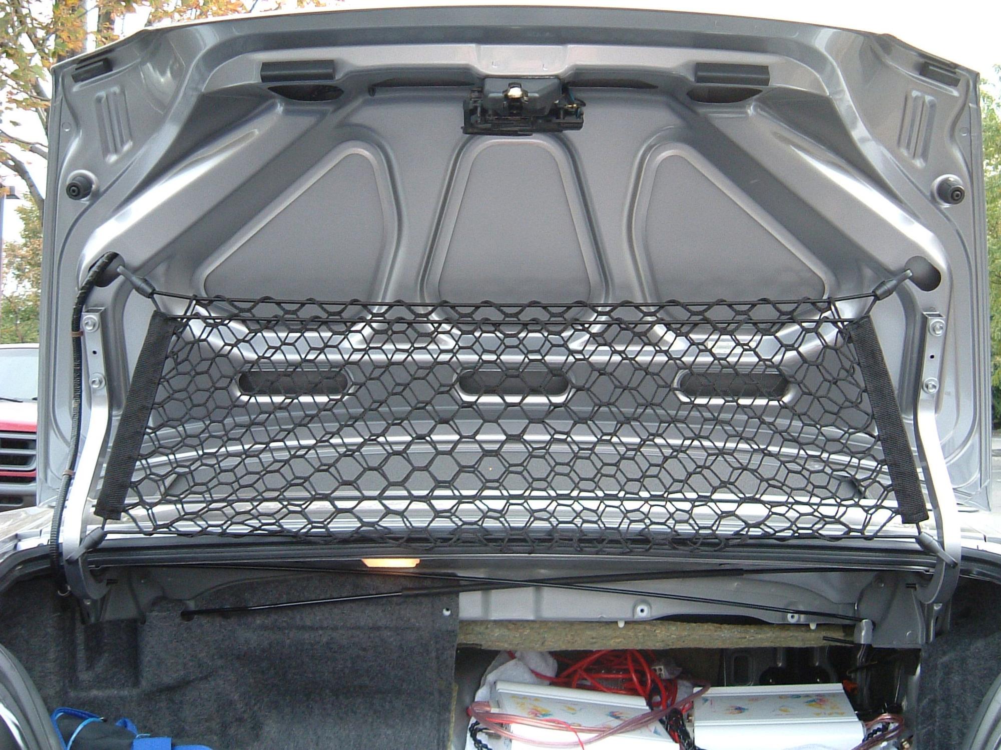

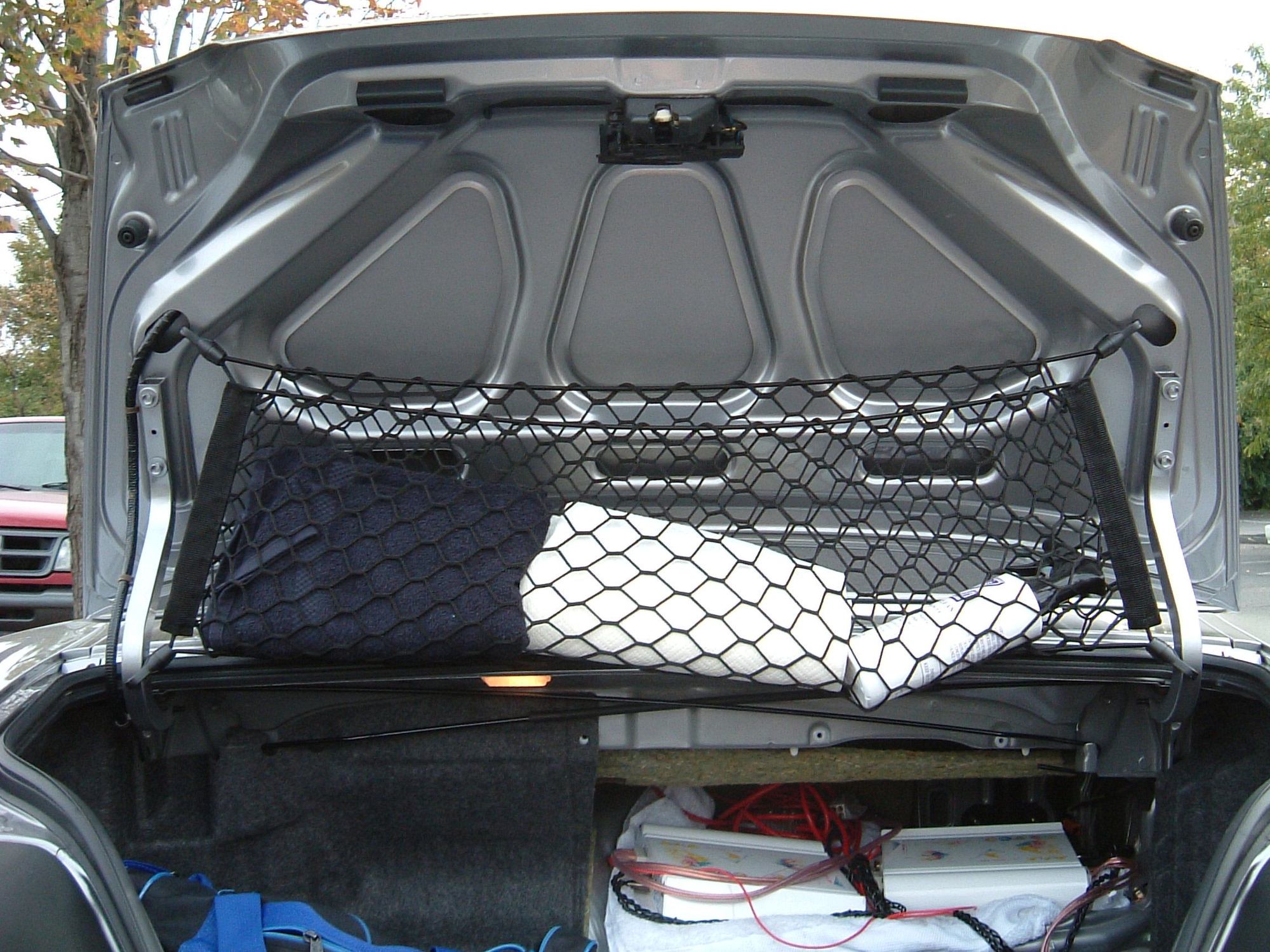

bravo. nice job and great pictorial.
just as a question -- the cargo net install in the trunk? can you post some more photos and details on it? until i can get a speaker grill for my sub, keeping it protected is important and cargo nets help...

PJK3,
Thanks to you I got the DCI wiring correct. Thanks for your help.
Here are some pic's of the cargo net. It's off of a 04 Maxima.
Loaded
Empty
