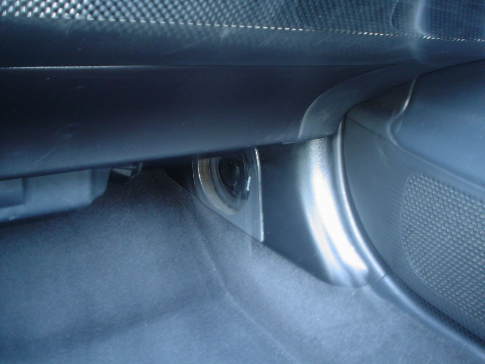

I glanced through some of the posts and saw someone mentioned theres not enough room in the kick panels for drivers. I might have missed part of the conversation, but here are some pics that it is possible.

Do you have more info on this install? I'm wondering where and how they moved the wiring out of the way and where they moved it to, to fit that speaker on the drivers side?
And do you have any pictures of the buildup?
