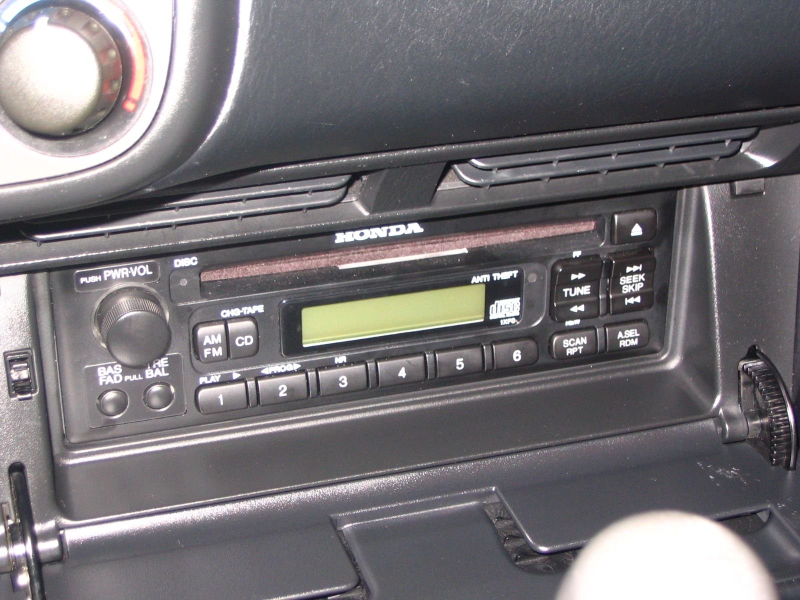

Got my new deck. How do I pull the old one?
Thanks!
Old Sep 10, 2005 | 01:22 PM
xviper's Avatar
Joined: Mar 2001
Posts: 37,305
Likes: 19
Grab the open door and start wiggling and pulling. Once the lower corners come loose, you can carefully pull the sides to free the clips as you go up. Once you get to the top, the whole thing with vents and all must be wiggled and pulled downward and back. Now you will see the screws that must be removed to pull the HU out.

Do you know where I can see some photos?

This may help:
https://www.s2ki.com/forums/index.php?showtopic=251894

Your post worked great! Thanks more than I can say.

I kinda disagree with needing to use any tools to remove the front door from the radio. If you just grab the door when its fully open and pull straight back the bottom will pop off.. then just wiggle it back and forth while still pulling the rest of it will pop right out.
It sounds hard but its really easy. I can one off in about 15 sec tops... and that's a new one.
Make sure you put the car in either 2nd, 4th, 6th or rev. to make your life easier.
