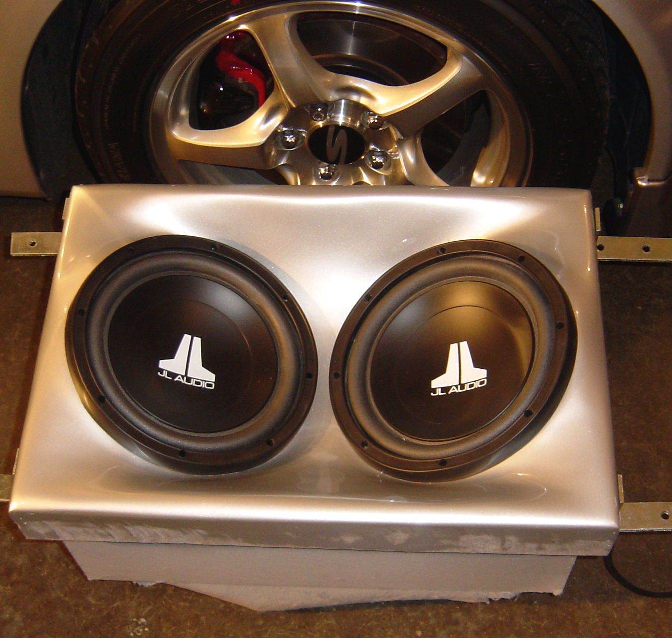

Thanks, Mr. Knight! Based on JL's site, I need between 1.2-1.8 cubic ft of air. I am using two subs. I'm going to do the "styro"-thing just to say I've done it. I'm also going to check this enclosure- my current one:

That looks good, a little big, but the paint work is nice

Thanks. It was not meant to be on top of the liner. It sits a little lower than the picture. Not sure if it's too big air-wise, but it is tall. Can't get the clubs in the trunk. That is one of the reasons for the change.
