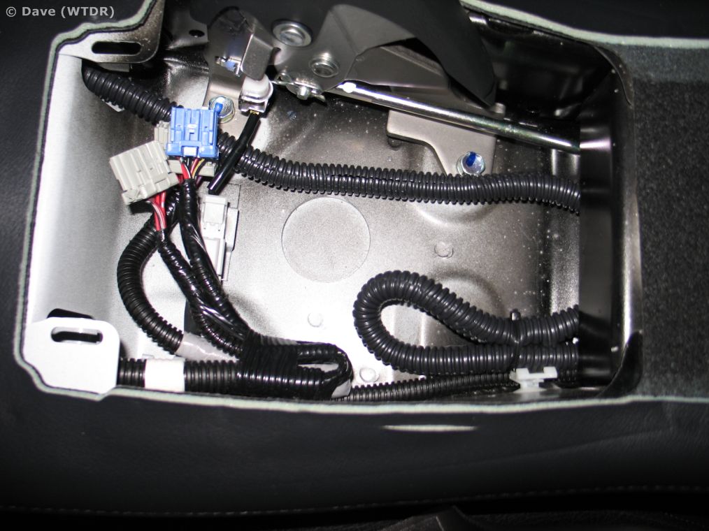

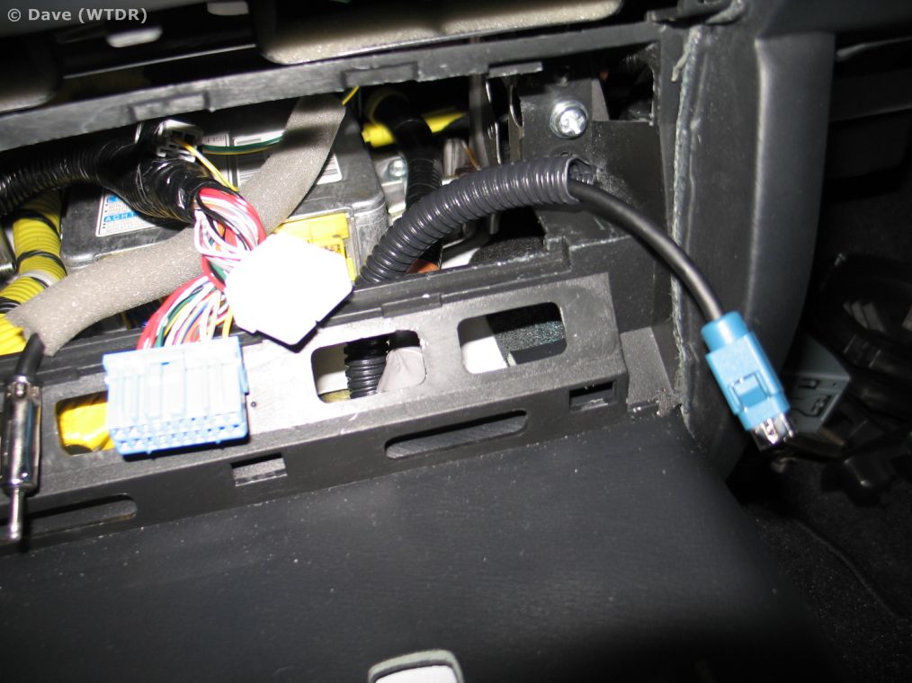

You need to remove the center console piece that holds the roof, hazard and (depending on year) defog switches, cupholder thing, etc. to do so, put your fingers (or something else that is fairly soft, screwdriver with a rag/tape around it, etc) under the perferated (sp?) leather portion near the rear of the part and lift. Do NOT lift the main piece that has leather from the front to the back, you just want to lift on the piece at the top. Once you remove one side, switch to the other side, then go back to the other side but move forward about 8" or so (you'll feel where the snaps are), lift, other side, lift, then just work your way forward one more set of snaps that are closer to the middle of the console. once all 6 things are unsnapped/removed unplug the harness and more the console out of the way. I removed the shift know to make it easy.
Here's a couple of pics of my car with the center console removed, you can see the back holes where the snaps go here.
here's where the next set are (right where the cupholder is)
you can't really see it, but the snaps go in that hole (well one of them does) at the very bottom of this pic

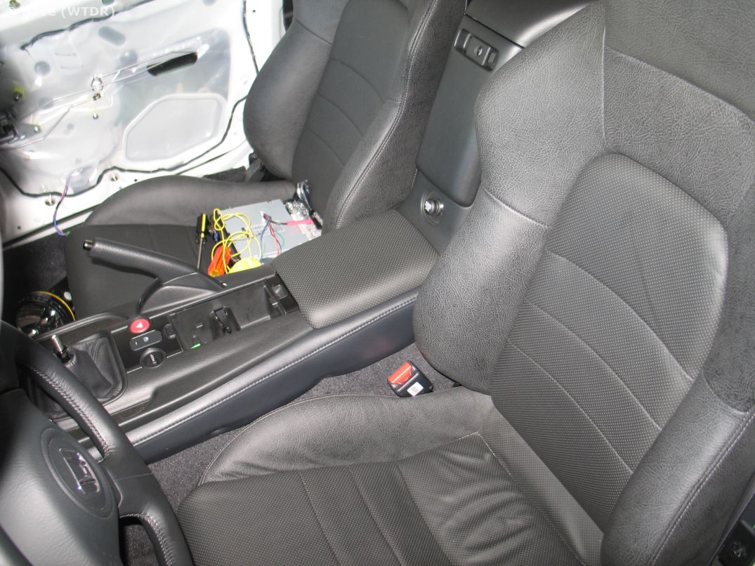

Here it is with the center console installed, the part you need to remove is just the very top part of the console, with the switches, shift boot, etc, leave the big bottom piece alone.
