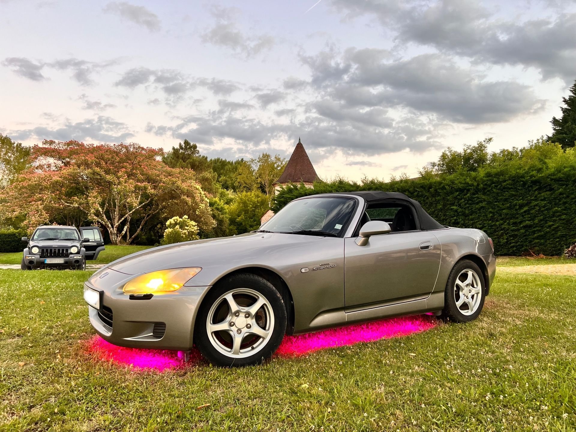

Hi All,
Bought myself some awesome neon lights for the underbody of my S2000, all is good and fixed and wired properly, the only issue I have is I can only switch them on with the headlamps on, is there a way I can wire them to a fuse where I can switch on another way, side lights would be acceptable, or better still another way altogether? It seems both the side lights and headlights are on the same fuse, and the neons only come on when the headlights are switched on, when I turn the switch once to turn side lights on the neons don't come on, only on second turn with headlights, would be cool if I can find a way to turn on without the headlights.
Does anyone have an idea?
