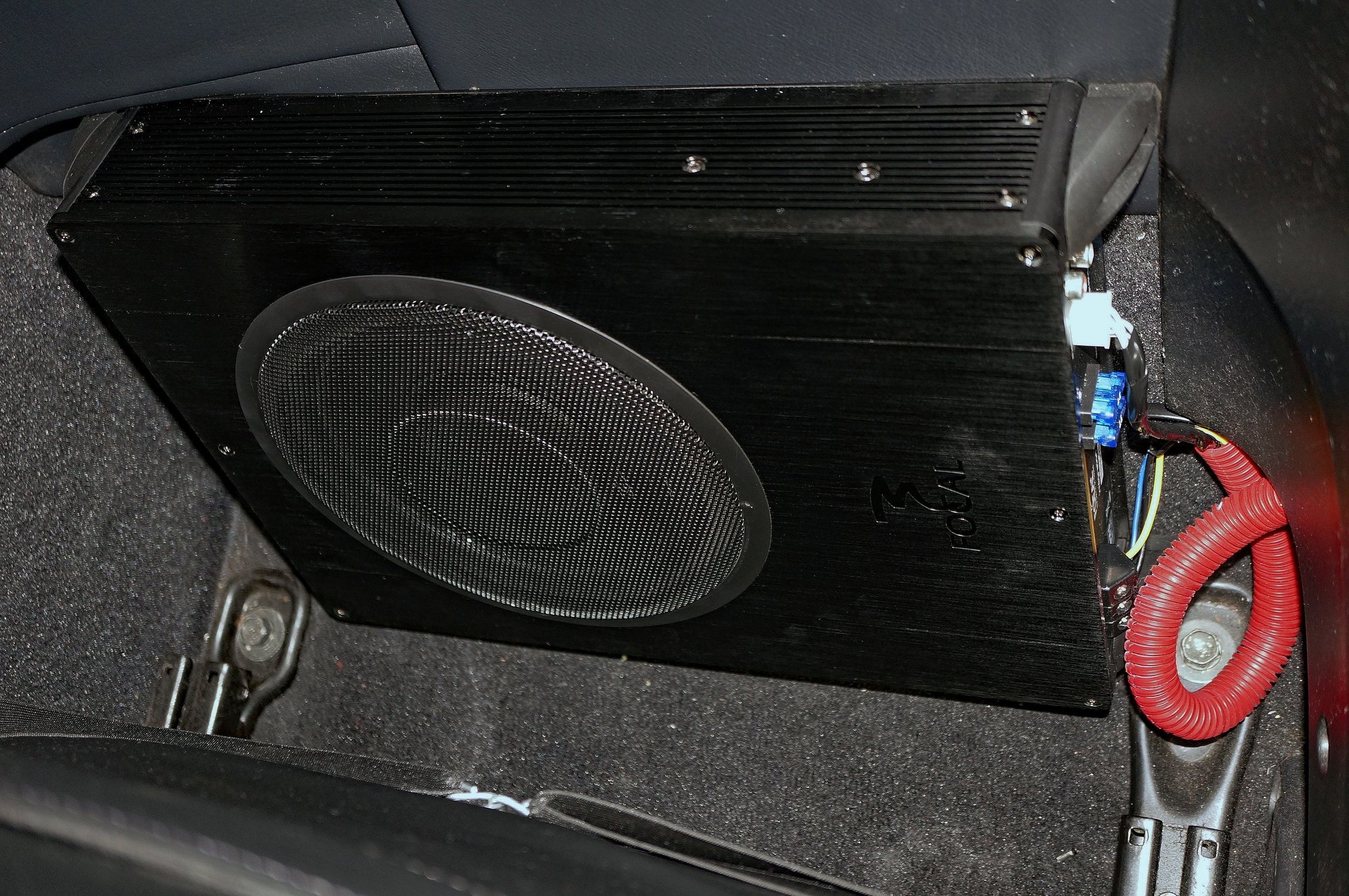

The S2000 needs a powered subwoofer. Bass is sucked right out of the car, due to lack of roof and adequate sound dampener.
I have a Focal IBus 20 powered subwoofer behind each seat. Focal prices have really gone up, since I installed mine. One thing I can say, the setup is 8 years old now, and works as well as the day I installed them.

You can keep the 6-inch speaker in the car door. I did. I just added the SW to my Alpine head unit. Subs fill-in the sound, not just the bass. Makes the imaging better. Fuller.
And yes, I thought it made the biggest difference. I mounted my SW on the false wall behind the seat.

What sub is that?
Old Jul 29, 2023 | 08:50 PM
windhund116's Avatar
Joined: Sep 2014
Posts: 11,386
Likes: 1,796
Focal IBus 20.
