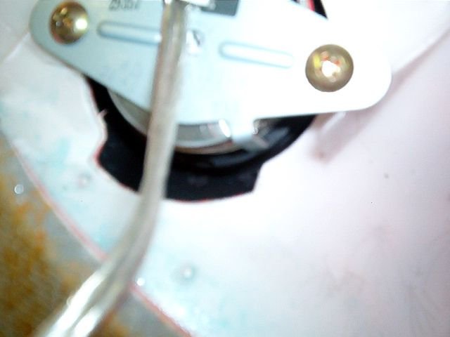

This is how I did mine:
I mounted the new tweeter mounting cup to the stock tweeter pod. I did this by Dremeling out the stock grille to the point that the new mounting cup fit into it flush yet tight.
Once the cutting was done and it fit into the stock pod perfectly I used the stock mounting metal bracket and using a small nut and bolt bolted it to the new mounting cup.
Then I wired it up and the end result was:
If you need more help please let me know.
-John

Can you take a few pictures of the tweeters for me I need to see them next to the pods... I'll come up with something.

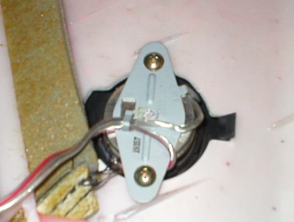

I have the Focal 165W speakers and here is how I mounted the tweeters.
I removed the tweeter from any mounting hardware. All I had was tweeter and wires. Then I wedged the tweeter into the tweeter pod in the door. It fit tight in there.
Then I put the factory bracket on the back. I used a little hot glue to hold the bracket to the back of the tweeter. Put the two screws in and connect it to the crossover and you are done.
Hope this helps.
Jim

Thanks Jim,
I was thinking of trying something like that. The tweeter seemed to just barely squeeze between the posts. I'll give it a try.

Had a professional installer put my Utopias (2-way) in last year.
RE: X-Overs - instead of the door or underdash, I had them mounted in the shallow compartments in the wall behind the seats that some use for rear speakers. This way I can get at them if I have to for adjustments.
RE: Tweets - I was able the keep the stock grills. I wanted a stealth look so people would not see what I had and want to rip them off. Here's a bad pics of the tweet install from the back.
Hope this helps.
