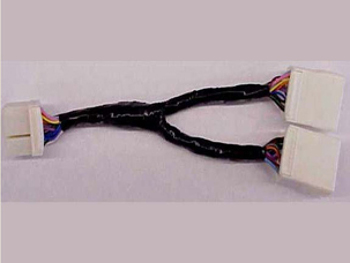

I bought iPod adapter P/N 08A28-1J1-1000-01 for my 2003 OEM Radio to add my MP3 iPod player. The plug that is SUPPOSED to.fit the back of my radio doesn't?! What's UP? I have got to be missing something?

Ap2 radios have the xm port.

AP2 radios were supplied by a different manufacturer from AP1's. They are plug&play compatible with all
years of S2000's, but the accessories (XM tuner and trunk-mounted CD changer) are different, and use a
different connector, as you have discovered. AFAIK there there aren't any adapters to allow you to use
mismatched accessories.

I'm guessing there are at least four (4) different radios in the S2000 all specific by model year since there were no optional radios. No clue of the differences though. Optional XM radio was a dealer installed option and would only work on radios with an XM port and button on the front panel. Notes I found indicates a "splitter" or kit of some sort is required to connect this. It's a generic "fits Hondas" and not specific to the S2000.
Maybe this?

This may be a clue but it's for a similar device for the Pilot. But who knows same thing by a different name?

That ‘looks’ like exactly what I need. I have a brand new in the box CD Changer that I can’t find right now. My mechanic is gone for the next few weeks. My job was to explore the fixes.
What I was told about the radios being all the same has caused me some problems but I’ll eventually get there and then tell everybody what happened.
