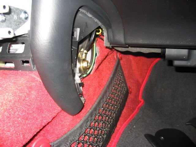

You should use the groment under the dash on the drives side to keep the power away from any new speaker wiring. Its under the clutch res.

Assuming it doesn't rain, I'm finally ready to bite the bullet and do the full HU, amp, front speaker install this weekend. Parts are all here, instructions and photo/threads printed, helper properly bribed - all systems go.
Another planning question though: I've seen a thread (which I can't find now) where the RCA's are all run through the center console instead of with the speaker wires down the passenger side. Is there enough space under the door sill to run 3 or 4 sets of RCA's AND the speaker wire (4 conductor 14 gauge)? I'll be added S-Pods and the Ipod do-hicky later this summer but rather put in the wire now that I have everything taken apart.

Yes, those wires will be fine on the passenger side. Make sure you lay them nice and flat not in a big tie-wrapped bunch. Once you open it up you'll understand.
