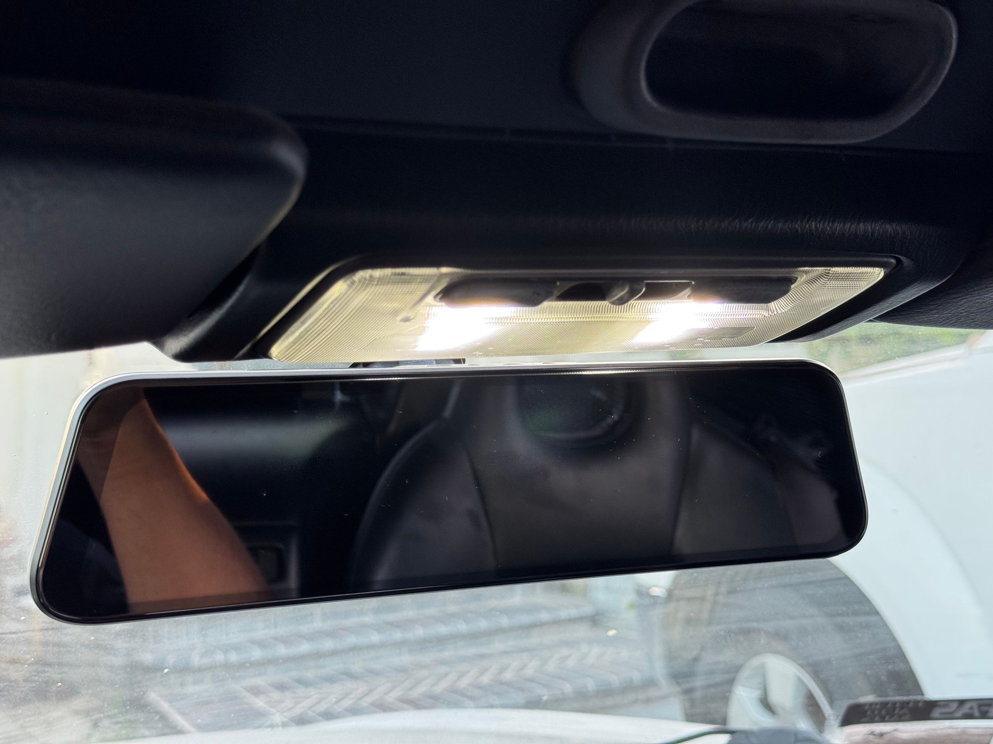

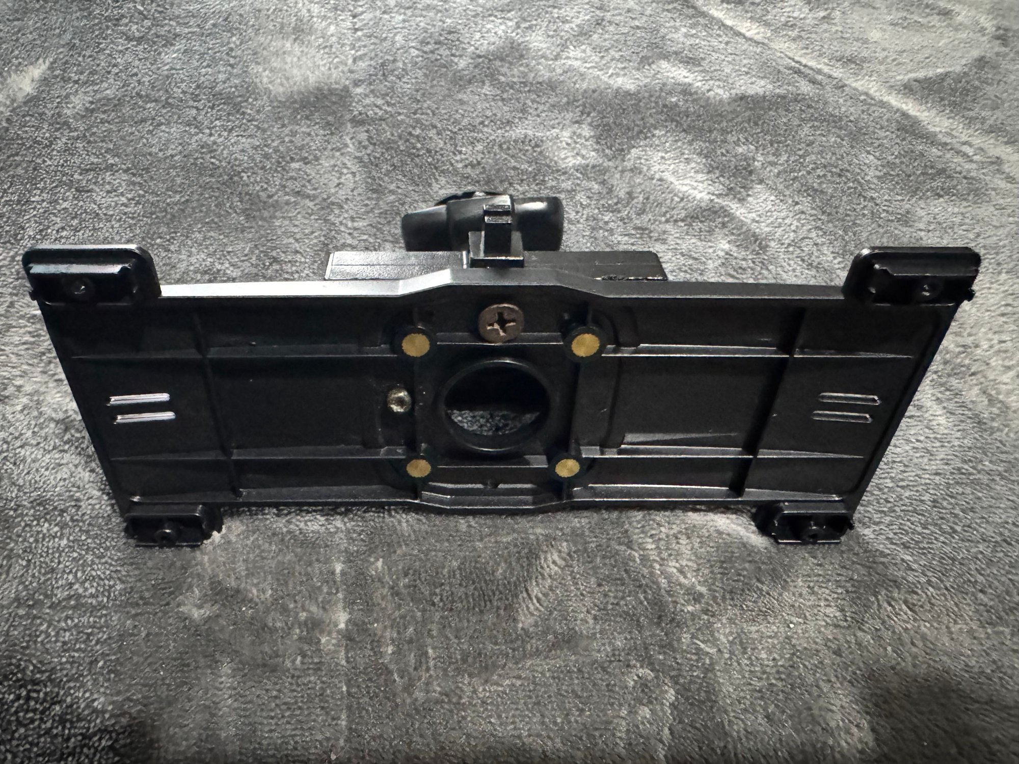

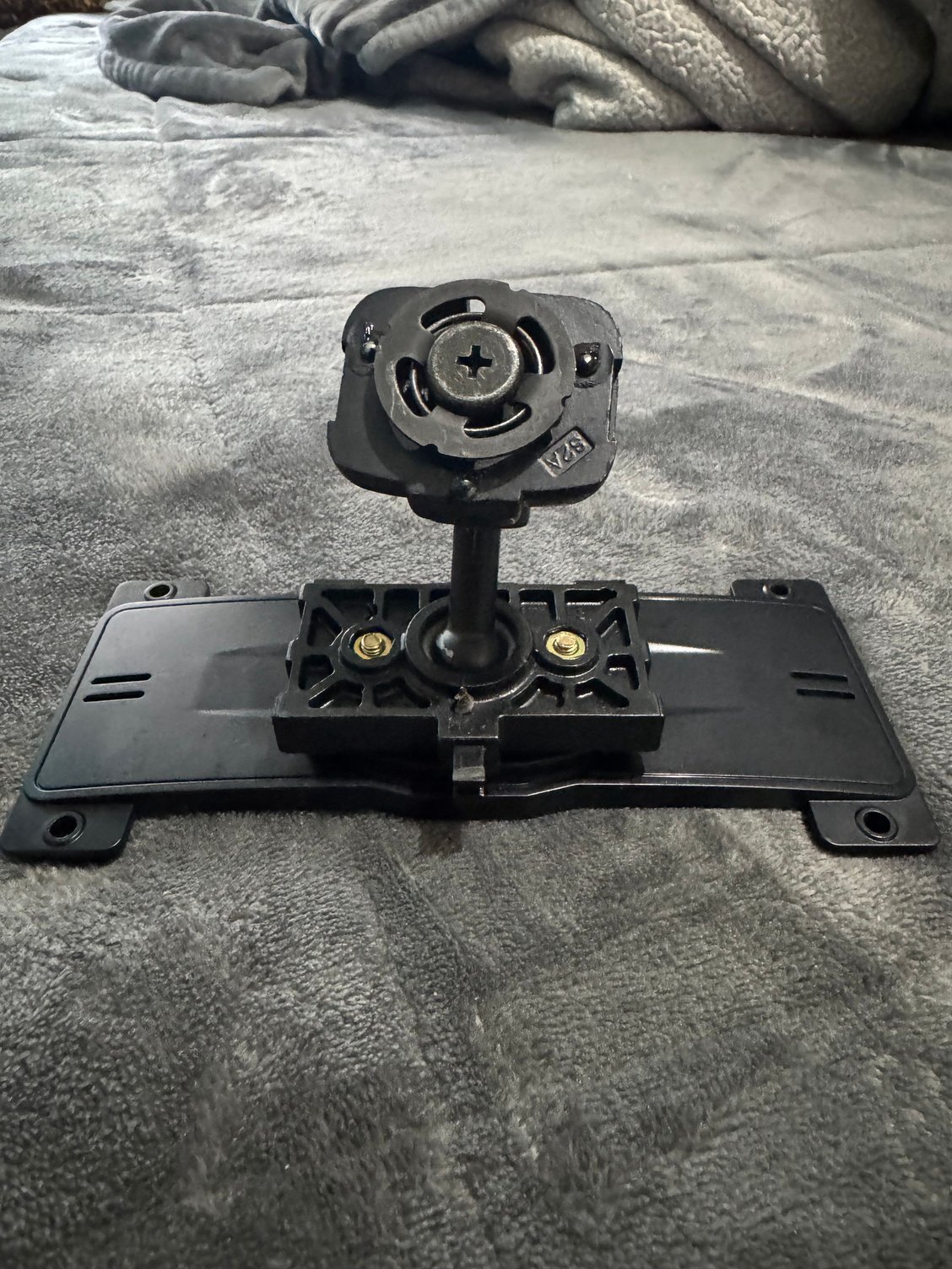

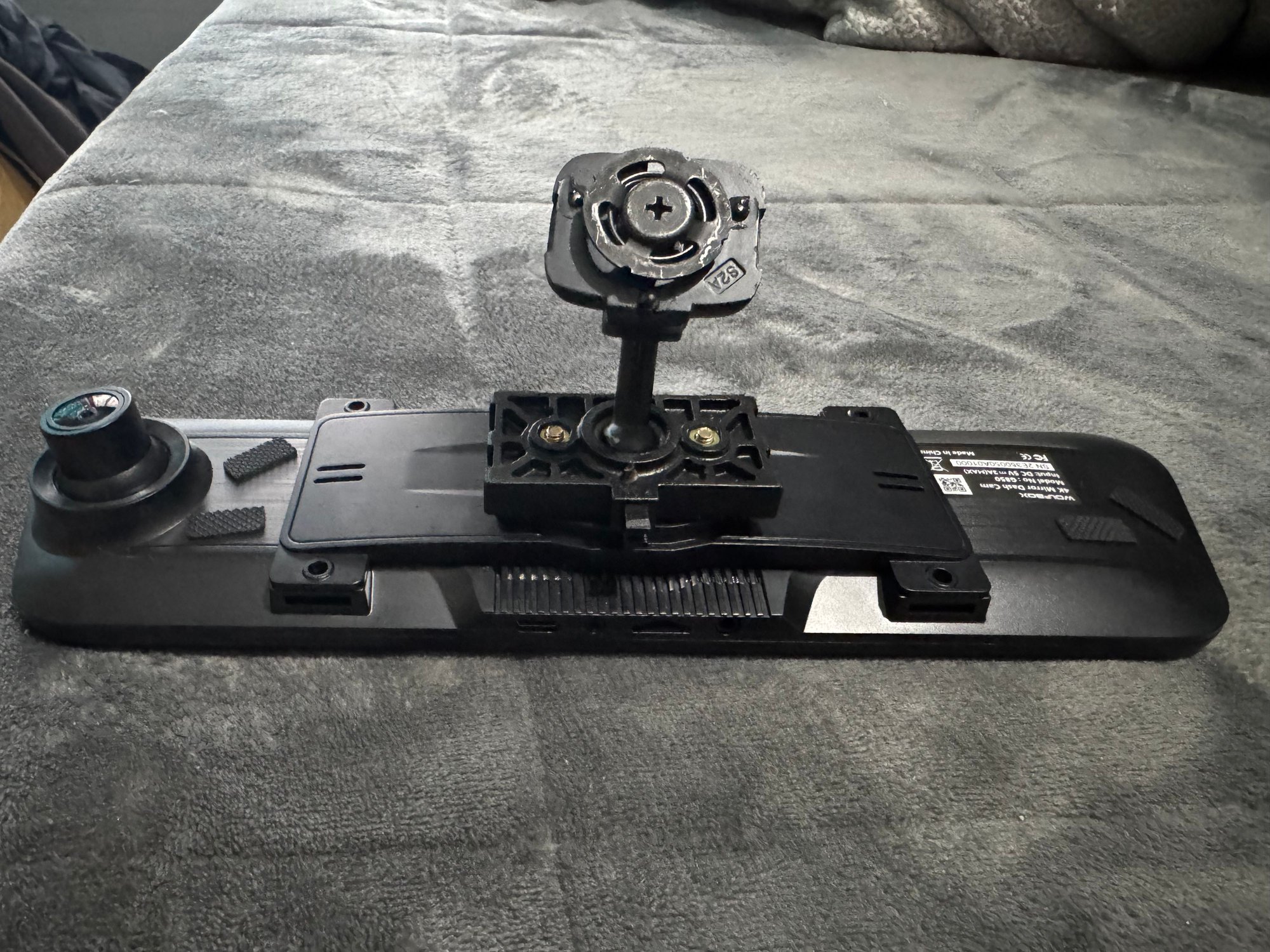

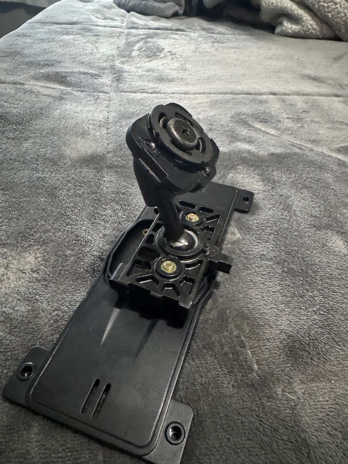

So I was gifted a Dashcam Rearview Mirror last Xmas and I had it installed on my 2011 Pilot. I've been wanting to swap it over to my S2000 and after some research found out that the S2000 and NSX use a unique mirror mount. I searched Amazon, eBay and on here only to learn no one makes a mount for these Wolfbox dashcam mirrors. I saw someone had hacked their OEM mirror to get the mount to work with the new mirror. I was thinking of epoxing the OEM mount to the dashcam bracket but then i thought, its plastic, I can just drill some holes and use a couple screws to hold it in place. Easy Peazy. Tomorrow I will run the backup camera and power, but this is the mirror install for now.

Wait… looking back at your photos… it looks like you just screw the wolf box adapter plate to the OEM arm?
Old Aug 13, 2025 | 06:57 PM
S2KRebel!'s Avatar
Joined: Jan 2025
Posts: 51
Likes: 19
[QUOTE=Trump.er;25126265]Wait… looking back at your photos… it looks like you just screw the wolf box adapter plate to the OEM arm?[/QUOTE
Yup.

neat. I didn’t think there was a plate to screw from the oem mirror. I assume maybe inside the casing.
I’ll pop her out today and see whatsup
Old Aug 14, 2025 | 06:02 AM
S2KRebel!'s Avatar
Joined: Jan 2025
Posts: 51
Likes: 19
[QUOTE=Trump.er;25126303]
yeah had to cut open my oem
mirror which was in bad shape so it didn’t hurt to do so

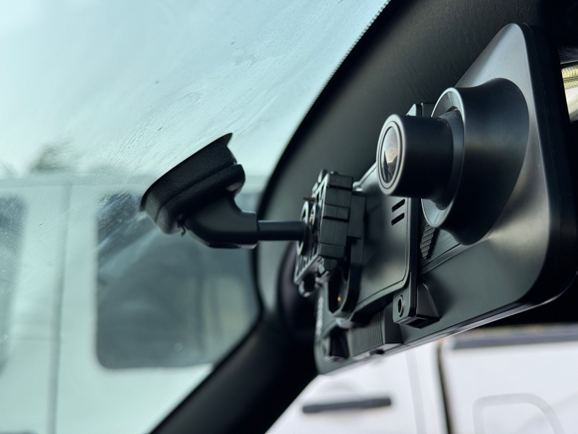

Got the bracket and mounted it but there wasn’t enough room when on the windshield for cables or fit so we had to raise the oem bracket an inch higher
Yeah, had to do the same, the cable to the rear camera was bumping with the windshield frame and it was messing with the video, so had to lower where I attached the Wolfbox bracket to the OEM mount like 1/4" maybe, was enough to clear the cables and not cause any issues.
I did notice that one of the screws to the Wolfbox bracket was missing, so its a bit loose, so I'll have to order a replacement screw after I figure out the right size/thread screw i have to order.
