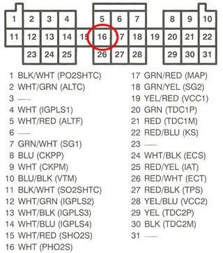

This white wire SHOULD be C16 according to the Helms diagram. Red/white below and white/red above C16.

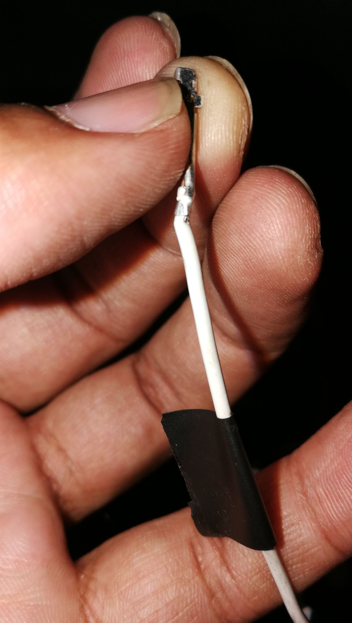

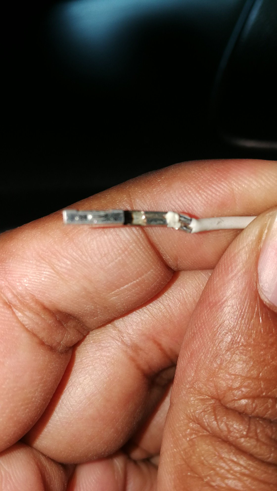

AEM AFR wideband white wire with an ECU terminal crimped on. Is this crimp OK?

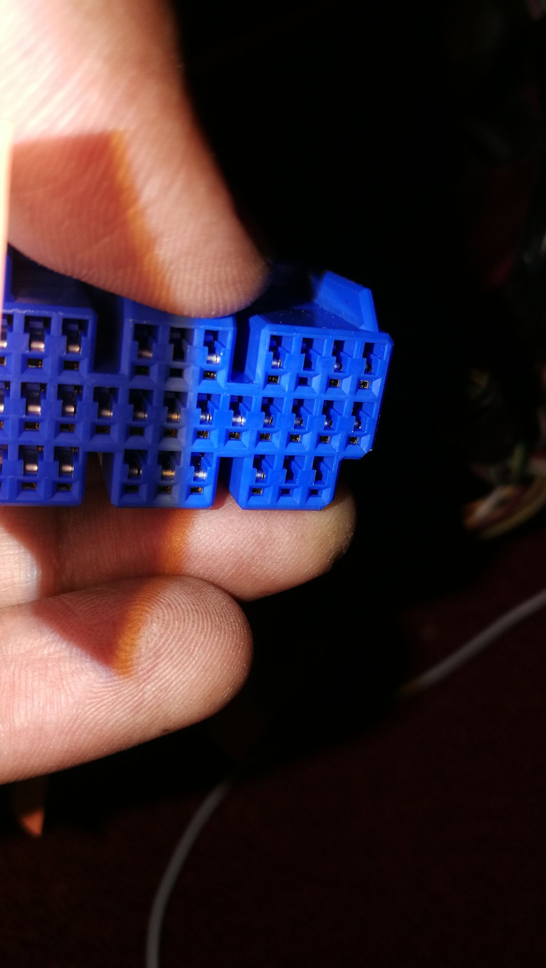

Could i actually depin C16 from this plug or is this going to be a big fight? I really don't want to put strain on the plug or wires
If depinning fails, would it be OK to shave the OEM C16 wire and then splice (solder) the AEM wire into it or would that pose a signal problem? I completely removed the OEM O2 sensor from the header and unplugged it from its harness that goes to the ECU. Or should i just cut the wire and splice the AEM wire into it that way?

I just cut my wire and fitted a female crimp to the ecu side of the wire and male crimps to both the original wire and the new wideband signal wire. It means if I ever go back to stock I can just unplug the wideband and reconnect the original. Use decenr crimps and a good quality crimper and you won't have any issues

I de-pinned mine. It makes going back to stock easy, which doesn't really matter in my case any more.

Yeah man I managed to depin the OEM wire successfully and pin the AEM wideband wire into the plug without much trouble. I'm tuned up and rocking and rolling now
