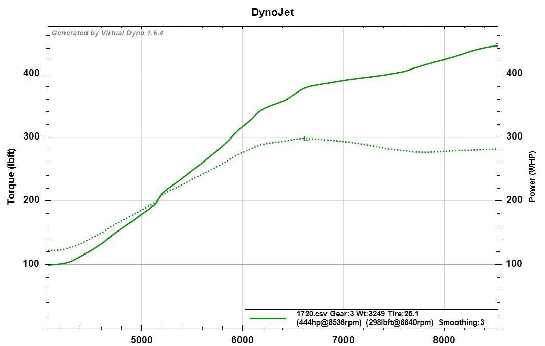

Finished up a 93oct AP1 turbo car today....runnign on 1650s 450 pump, soon to be Corn Fed. AEM EMS V2
Stock motor on BW366, 12-13lbs and at a 3100DA today on very safe timing made 445/300tq
90 degrees and high humidity today.
Only rev to 8500 too LOL
