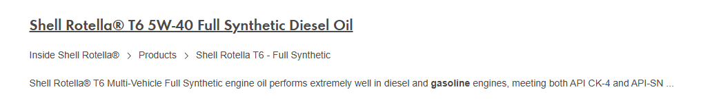

So, I watched that video as well.
And, specific to note that it's the conventional oil T4 formulation and in 15w40 rather than the more popular T6 full synthetic in 5w40, which is mainly what gets used in gasoline vehicles (and among the motor cycle community as well).
The T6 - 5w40 was a big carry over from my days as a subi-STI owner. It also meets standards requirements for API CK-4 and API-SN for gasoline engines.

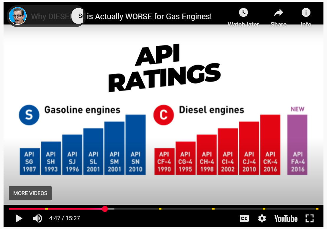

Ok, so, using the rating chart from the motor Oil Geek Chart below:

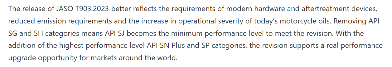

So, all of the Rotella T6 oils are JASO rated, picture below later. Only the 5w30 formulation of T6 has the API-SN rating; however, hear say is that the T6 5w40 used to have the SM rating, but they didn't want to pay the license for it. Again confirmed that it does have the JASO rating, which is important here, as JASO has cross over with a bare minimum "S" rated oil.
From here: https://360.lubrizol.com/2023/JASO-T...cation-Is-Here

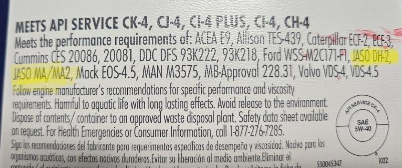

And, on a 5quart bottle of T6 5w40 (JASO highlighted in yellow for convenience)
