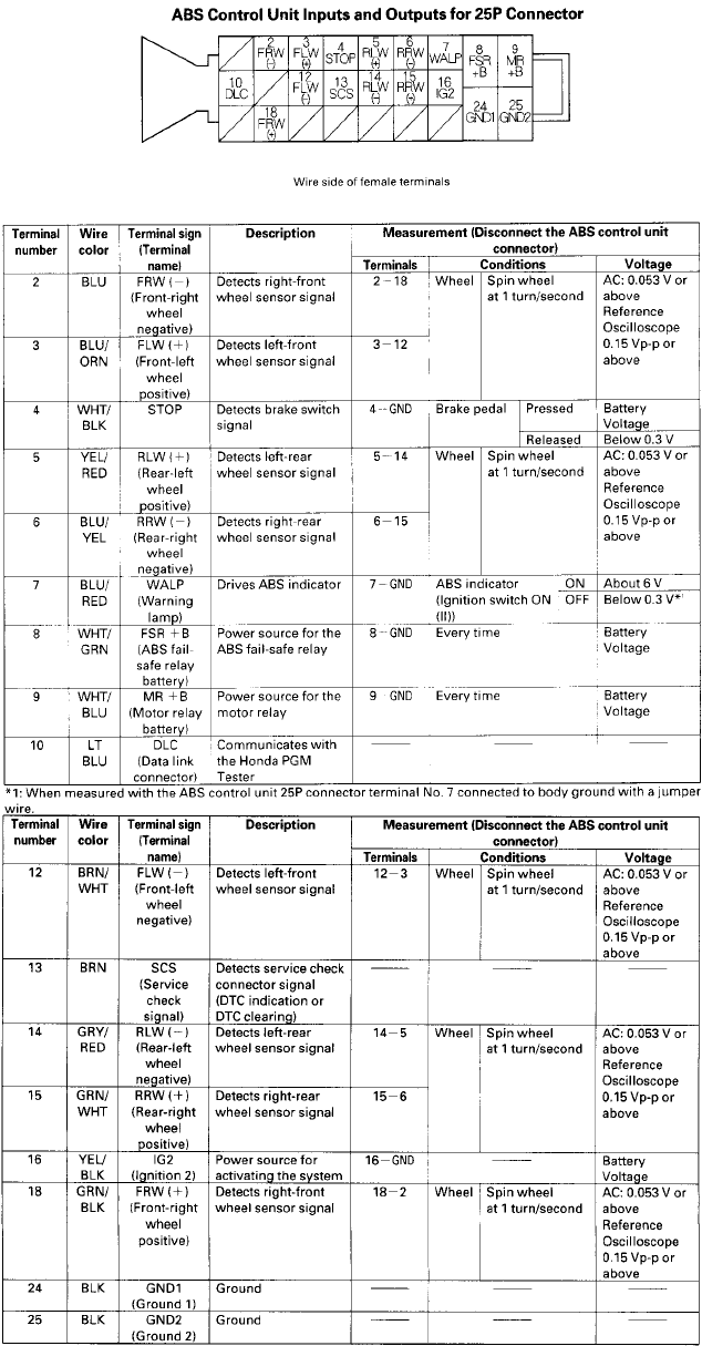

You can check the sensor function pretty easy with a multimeter and some help from someone spinning the wheel.
I hope this picture is self explanatory.

Thank you for that chart. Will test everything this weekend.
