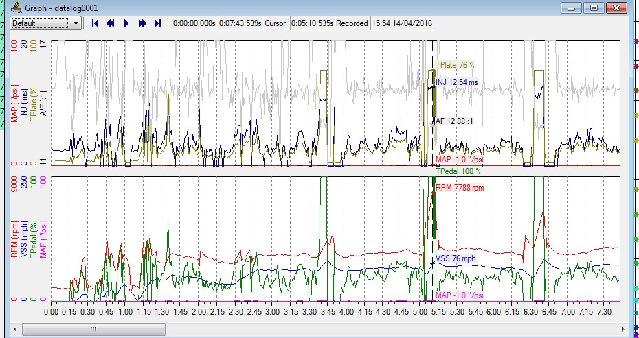

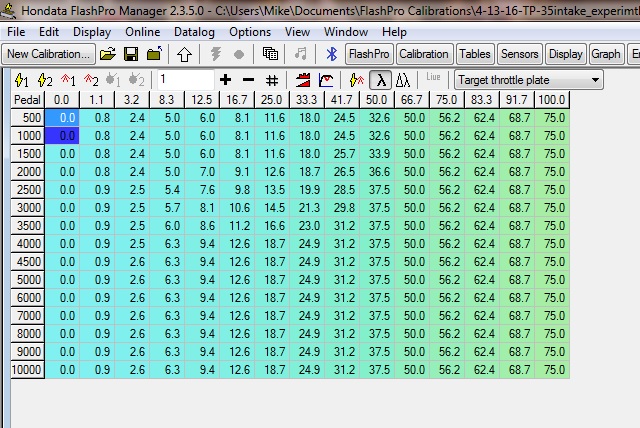

Ok so I've tinkered with this a little and I'm a little perplexed exactly wtf is going on with the throttle plate in relation to the throttle pedal. Has anyone confirmed that the TPlate % reading in datalogs is in fact accurate? As in a 75% reading = 75% opening, and 100% = WOT? I created a scaled throttle table where everyhthing is scaled to 75% (I chose 75% since I figured it was sure to be WOT if it's estimated to be ~66% by others).
Here's the table I made:
[attachment=93612:throttletable.jpg]
And here's the datalog:
[attachment=93613:wtfdatalog.jpg]
I have two datalogs and they consistently show a throttle plate of 76% MAX, even though the pedal is 100%. Is this not what you guys saw? It's always possible hondata changed some code but maybe the fact that I don't have 100% tpedal = 100% tplate it's screwing things up? I'll have to try some other things but I guess it doesn't work how I thought it did.. :/ On another note the driveability with this throttle table is improved, but if I can't hit WOT that's no bueno.

That looks correct to me. You set the value in the 7788 RPM and 100% TPedal block to 75% TPlate and you got 76% TPlate instead. What we are saying is that while that says 76% TPlate, the reality is that it is 100% TPlate. I am assuming that the car felt like the car was at WOT when you made that datalog.

I can tell you I did back to back datalogs setting 100%TPedal to 100%TPlate and 80%TPlate, and there were ZERO differences in the log. I pulled the same amount of boost, the third gear pull from 3500 RPM to 8300 RPM took the same exact time. You need to realize that what Hondata displays in the datalog as TPlate is not actually what the throttle plate is at.
