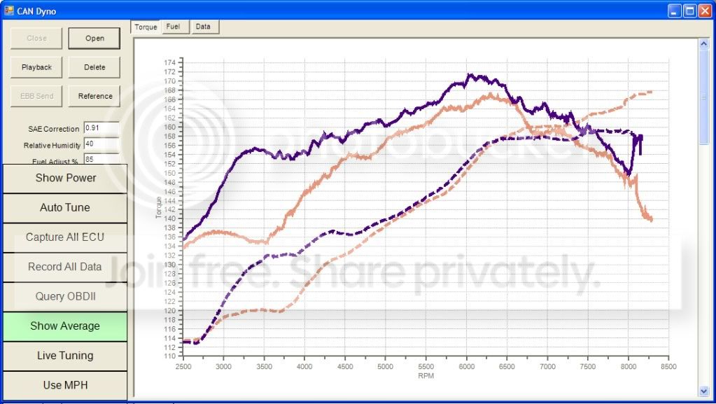

Have you ever wondered why totally stock Hondas have such "spikey" AFR's at WOT? Do you think Honda just did a crappy job on the factory tune? After all, everybody knows that a good custom tune has a nice, flat AFR on the dyno (I'm kidding)! Here's an old AFR plot from my car when I first started tuning it. The blue line was from the stock tune. Note that the AFR bounces all around between ~12.5 and ~14.5!
Well, I finally understand why! It's because Honda didn't tune the car at WOT! They tuned the entire map at partial throttle, since that's the only way to be sure that the car will perform well at any altitude and also have decent fuel economy! Since our ECU is based on manifold pressure (not throttle position), the ECU gives the same amount of fuel at 900 mBar no matter what the position of the throttle plate is. However, the "ideal" amount of fuel (and timing) changes a LOT based on the position of the throttle plate! This is due to the huge impact that intake resonance has on ideal fuel and ignition without having much impact on manifold pressure.

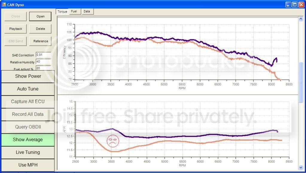

Since I don't drive my S2000 at significantly different altitudes, and am much more interested in peak performance than I am fuel economy, I went the other way with it. I tuned for optimal AFR and ignition timing at 100% throttle. That choice costs me quite a bit when MAP is near peak with a partially closed throttle (the "crap zone"). Below is a screen shot of the target throttle map that I used to see how part throttle / full load differed from full throttle / full load. I made it so that the throttle plate would slowly open as the RPMs increased even though my foot was all the way to the floor. The resulting manifold pressure was almost the same as if the throttle plate was fully open. Below that is the resulting torque plot and AFR from that throttle map compared to the "stock" throttle map. I should also mention that the torque plot shows dashed line that represent the fuel curve. I wish I would have fixed that, since it is very misleading. I had already tried "tuning out" the difference unsuccessfully using the fuel table. Let me assure you that the data I'm showing is NOT caused by that. These are just the best screen shots I have to deliver the message. I don't have any more time to invest ...
Note how much the curves differ between 3K - 4.5K, which is where most driving occurs! Also note that it would be MUCH, MUCH better if the AFR for the part throttle condition was LEANER than the full throttle condition, but it's actually much RICHER! Now I know why my back bumper is black with SOOT and my fuel economy sucks!

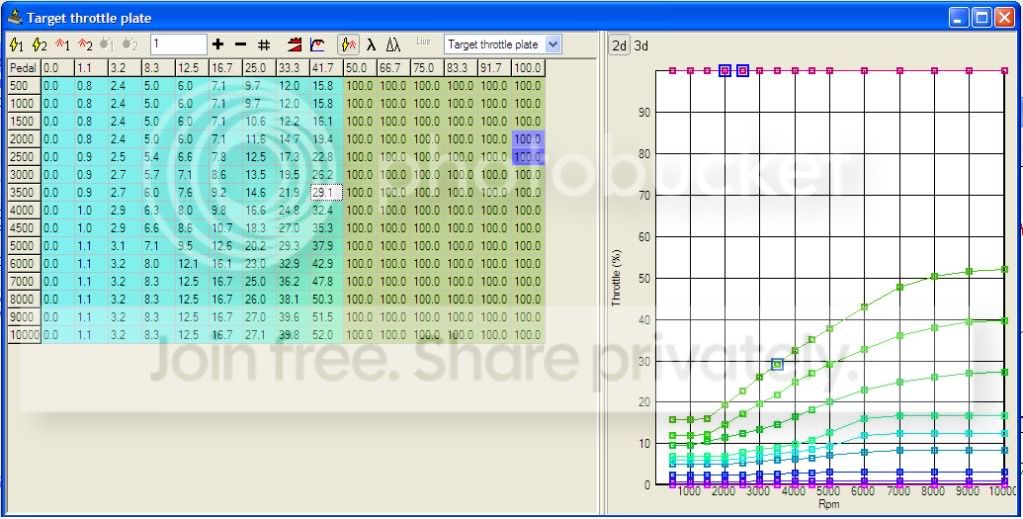

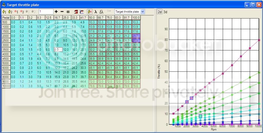

After thinking about it for a year or two, I realized that the issue might be correctable using the target throttle map. Below is the stock throttle map with some illustrations. Note that the values in the table don't represent actual throttle plate position. The values are actually multiplied by ~1.5, so if you have 66% throttle plate at 66% throttle pedal, that results in an actual throttle plate of 100% at 66% throttle pedal.
I spent a few days geeking out on it, and found that if I optimized my target throttle map so that the throttle plate would transition very, very quickly from mostly closed to fully open once I was near full load, I could avoid the "crap zone"! Now I'm able to make a small change in throttle pedal position, and the throttle plate will go from ~30% to 100% rapidly to avoid the area where the AFR goes to crap. It seems to also give a better throttle response, since that part of the throttle used to do virtually nothing.

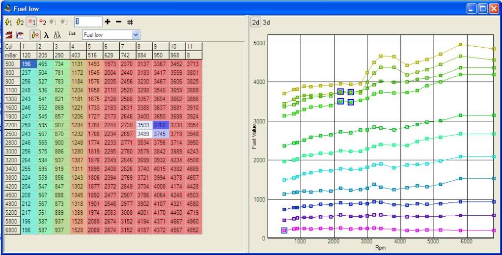

I forgot to include the shots of my updated fuel maps. I added a column for 950 mBar, since that is just below the atmospheric pressure that I've ever seen where I live, so I feel confident that any time the MAP is below 950 mBar, it's definitely partial throttle. I tuned that new column for partial throttle plate.

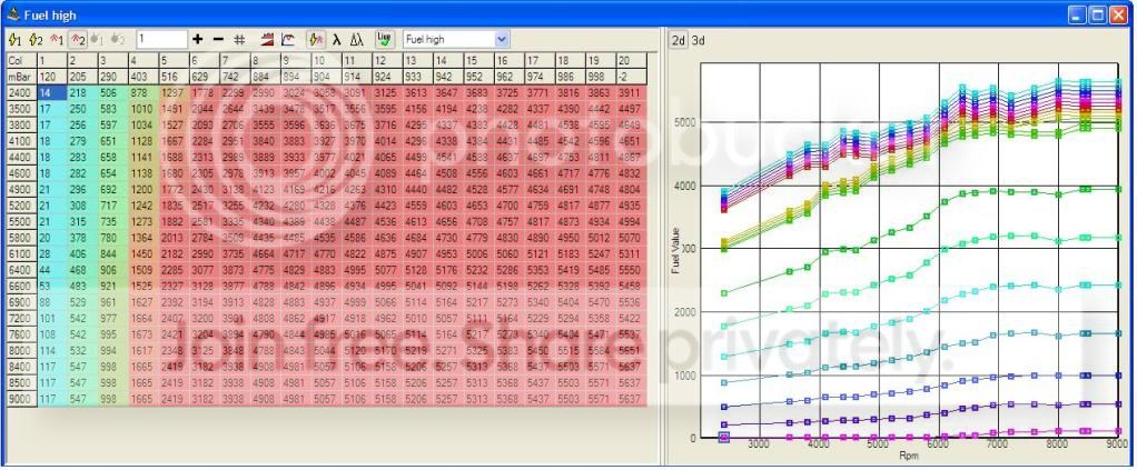

Sheesh ... now I realized that I forgot to include the screen shot of my new AFR plots showing the difference between the true full throttle and "crap zone". It isn't perfect, but it's on the right side of perfect (not uber-rich)!
