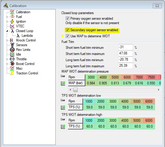

I just purchased a flashpro and I've been doing some research on this forum as well as the hondata forum. Gernby is helping me out with a tune. However regardless of the calibration I need to know how to disable the secondary o2 sensor.
I read somewhere that the setting is under the Calibration > Misc but I don't see any setting under the OBDII Error Tests which relate to the secondary o2 sensor.
The other place I found settings are under Calibration > Closed Loop. There is a "Secondary oxygen sensor enabled" checkbox.
Is it safe to assume that this is the place to uncheck to disable the o2 sensor? I'm hoping to unplug it altogether at some point. It's currently installed (without a fouler) in my test pipe.
Thanks!
Chris

Old May 31, 2016 | 06:24 AM
SlowTeg's Avatar
Joined: Mar 2010
Posts: 4,742
Likes: 211
Yes.
Old May 31, 2016 | 06:48 AM
King Tut's Avatar
Joined: Jul 2014
Posts: 2,629
Likes: 53
From: Fort Walton Beach, FL
Yes.
