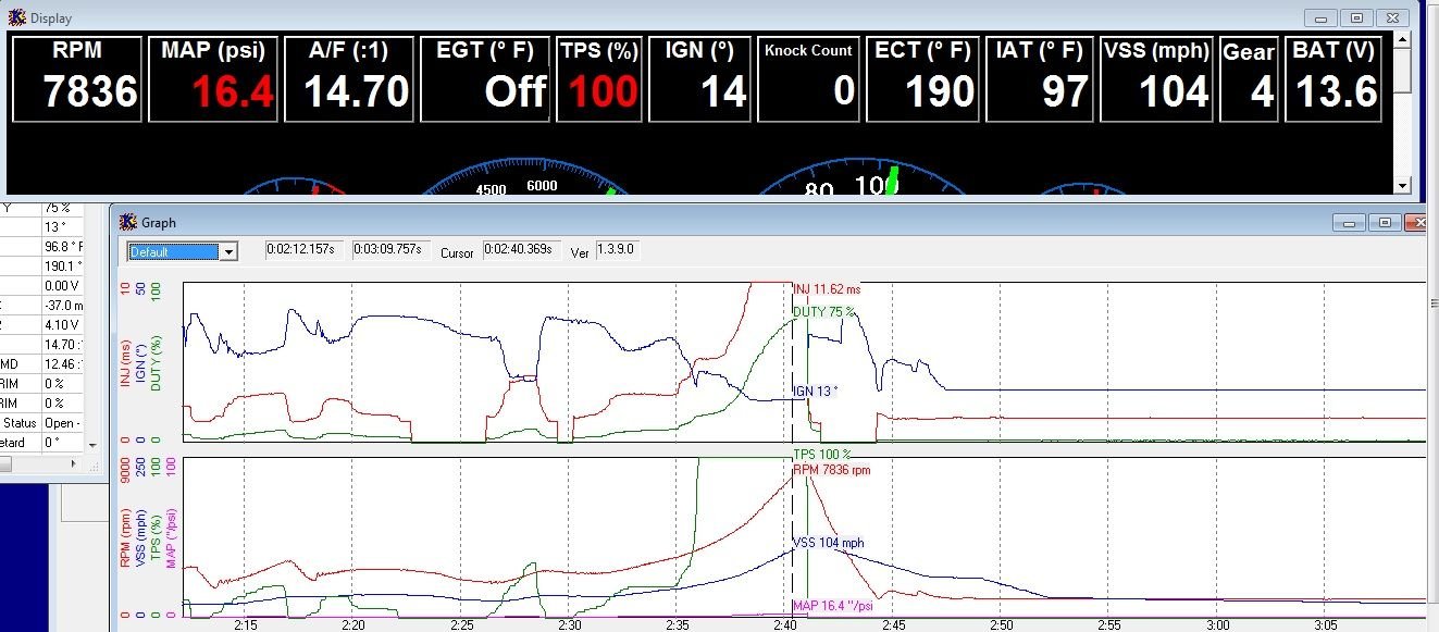

so i finally was able to get a datalog when my car "knocked". how can i tell why it knocked?
and what can i change to make that not happen?
thanks for any help or insight!

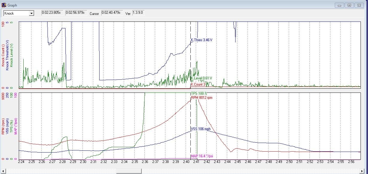

hm, yea i dont really know what i'm looking at/for, so any insight would be good
does this help at all? or is there anyway to tell ghost knock from real knock?
i'm trying to show that in the first pic, there was no knock, and the 2nd pic there was, the knock count went to 3 after the first dyno, up 2 to 5 the next run, and then up 1 to 6 after the 3rd.
these screenshots are from the first dyno run, let me see when the others occured

2nd dyno run knocked around 7500 and 7750, 3rd dyno run around 7250
