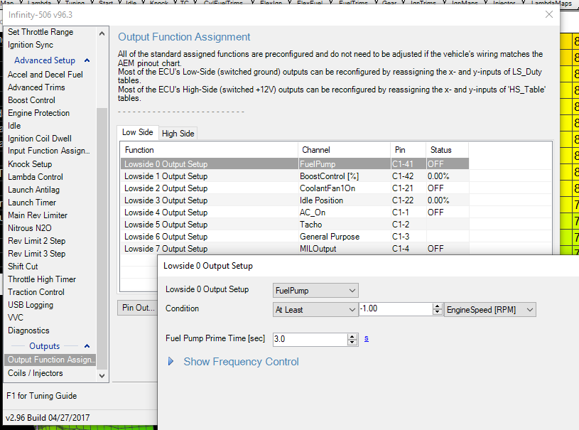

Originally Posted by afzan
it's very easy to change that setting:
I've been trying different things to remedy this . Nothing works . Myself and my tuner Jeff Evans have accepted the fact that there is some odd issue going on here . Perhaps when they eventually release V96.4 the issue will be resolved . Fingers crossed .

@joes sled 2000 , the long sync/start time or the pump prime?
My pump primes the second the key is turned and I even bumped it to a 3sec prime.
The pump prime . The start sync time is instant . The pump primes only when the key is on start .I've tried lots of different things to remedy this . It really doesn't bother me all that much . Again i run v1 in the s2k and Infinity in the Integra . The v1 is perfect , i just wish it had flex fuel option .
