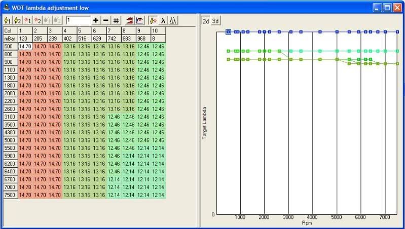

Originally Posted by thesilverbullet,Dec 31 2009, 10:08 AM
i wish hondata would give an option to change the closed loop a/f target..
Isn't that what this screen is for? What would you want to change it to, and why?
Old Dec 31, 2009 | 11:57 AM
93turbo16's Avatar
Joined: Sep 2009
Posts: 95
Originally Posted by gernby,Dec 31 2009, 11:00 AM
What would be the reason to limit the min / max STFT range for closed loop? That seems liike it would just prevent the ECU from protecting the engine if something went wrong (clogged injector, bad gas, etc.). Is there a performance benefit to limit them (assuming the fuel table is properly tuned)?
The only reason you would limit the min/max trim is reduce the fluctuation. This applies more to when you chagne injectors/map sensor, etc. The stock settings with the stock wideband should be just fine.
But what I was suggesting is to narrow the min/max trims that way your a/f ratio is more steady when trying to tune the car. That way you are relying more on the O2 sensor readings and not the short term %.
Don't change that table at all. Changing it too much results in the car wanting to run in closed loop at WOT. Just so you know.

From: south florida
the 2nd fuel map on the first post has a few large gaps. mainly between columns 7 and 8.
i like to aim for stoich from columns 1-6. start richening it out as it gets to column 7-8. try interpolating between breakpoints.
