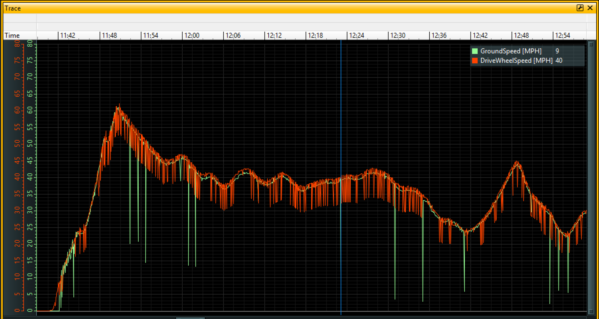

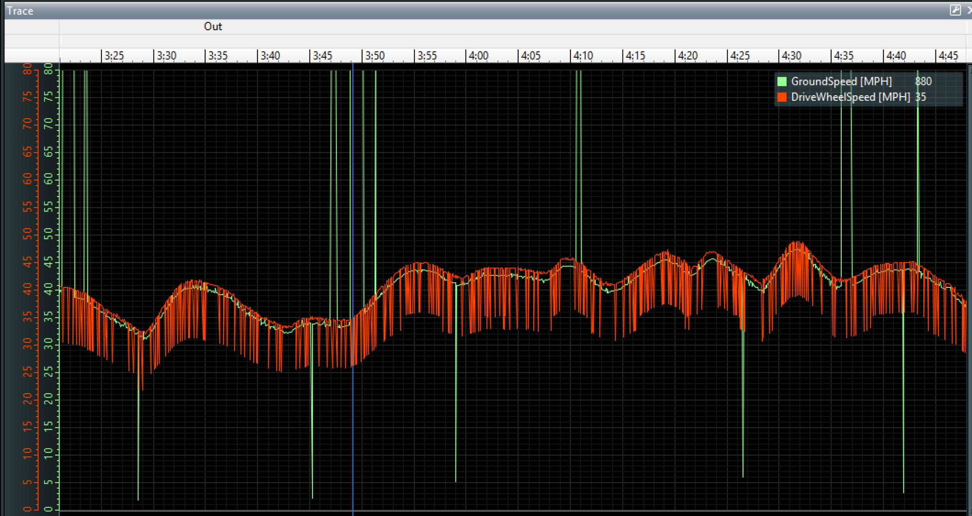

Here is the excessive noise I had when I first inspected the VSS signal and SOS pulse converter signal (from Digital6) after initial install -- various spikes to 880 MPH from the pulse converter and quite a bit of noise in the VSS signal:
SOS suggested I check all grounds, I had one that was loose. I also installed an extra ground kit to really improve things. After doing so I still had noise on my VSS signal but the random spikes to 880 MPH, without decel/accel below 15 MPH noted below in final graph, were eliminated:
To eliminate all the VSS noise I needed to tighten my connections to a "modifry yellow jacket" I have installed (to correct my speed in that I have a 4.44 final drive gear rather than stock 4.10):
Thankfully the remaining noise doesn't cause the AEM infinity's TC to kick (because it only triggers if VSS, drive wheel speed, is greater than the SOS pulse converter provided speed).
The green spikes up from the SOS pulse converter are discussed in this note I sent to SOS:
I am seeing spikes when starting from speeds lower than 10-15 MPH, or decelerating from
above 10-15 MPH. Almost like events (e.g. coming to a stop at a stop
sign) that slow the sensor below a supported threshold (15MPH?)
trigger the Pulse converter to drive the signal high and it then
gradually counts down back to the actual speed. Happens when I slow
down abruptly or start driving from slower speeds. Those are the
spikes you see in those lulls above. Otherwise the
SoS pulse converter output seems flawless.
SoS confirmed my suspicion about the 15MPH threshold:
The unit you have will have issues cutting out around 15 mph, which traction control isn't normally needed around there, which is why in our instructions we suggest you set the engagement higher to keep from seeing this issue.
Last important note I'll share is I found that turning off all signal smoothing or noise cancellation (that the Infinity is capable of doing, if configured) is important to get a clean singal.
