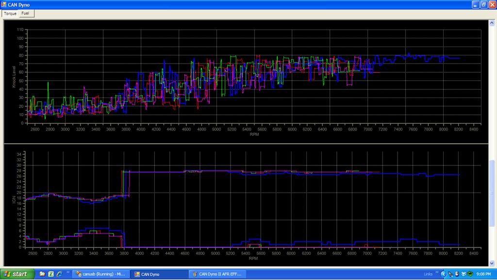

I apologize to those that have sent me PMs for updates. I've been adding new functionality so fast that it wouldn't make sense to post the new thread yet. I've just now added some of the tuning functionality that has been in the Excel Soft Dyno for a long time (hidden), and it works VERY well. I've also added some functionality to suggest ignition timing based on the fuel maps. It does help find the dips and bumps in timing that will generate a smooth torque curve, but I don't know how safe it would be to use on other cars.
I still don't know when or if I'll be able to give this to anyone, since Hondata doesn't seem interested in it. It's a shame, since I hate all this going to waste. If any of you are REALLY interested in using this, and are willing to buy a CAN dongle (I don't sell them), I'll give you the software for free. Aside from a CAN dongle, all you need is a "good" laptop with a multicore processor, and you'll be tuning like a MO-FO! The multicore processor is important due to the multi-threading that's required to get everything done in a non-Real Time OS (Windows).
Anyway, here are some screenshots from tonight's testing. The dyno plots aren't as consistent as usual due to the extreme heat soaking that occurred between some runs while I was debuging something. Multithreaded applications can be a bitch...
BTW, the top lines in the picture below are torque, and the bottom lines are the fuel injector pulse width.

What is this CAN Dyno program you have screen-shots of. Is this a supplement tool to your Softdyno?

I'll post a new thread soon with a link to download the new CAN Dyno / Soft Dyno. I recently added functionality to read in the FlashPro CSV files, but wasn't able to improve the torque plots all that much over the original Excel Soft Dyno. The best torque plots require a CAN Dongle in order to access the high resolution VSS data. Honestly, when using a CAN dongle, the torque plots are "better" than any DynoJet plots I've ever received. If any of you own DynoJet stock ... sell it.
