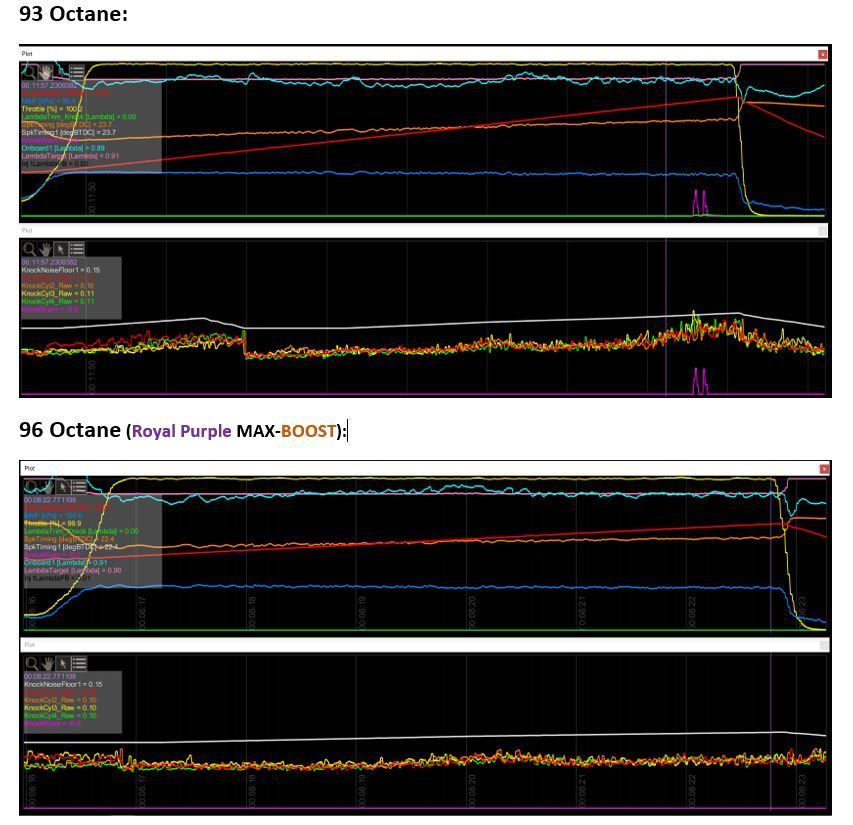

As I continue to test various ECUs I surely enjoy exploring their features, capabilities and limitations. So far I've created countless tunes for my car with the Greddy E-Manage Ultimate, have one year of AEM Infinity experience and also had some limited exposure to Hondata. All of this is done on my personal Honda S2000 which is a daily and a test mule for mentioned ECUs. My next victim is a Haltech ELITE however I am really looking forward to testing the MOTEC one day.
I can say with confidence that Greddy eManage (piggyback) and AEM Infinity (standalone) requires you to dedicate some serious time and effort into actually being good at what you do. On the other hand the Hondata and other flash alternatives alike are very forgiving and much easier to deal with.
This month's goal was to test over the counter octane booster. I had blindly selected Royal Purple MAX-BOOST which claims 3 point increase over your current octane rating, in my case that's 93+3=96. Results shown below display knock sensor raw voltage plot and the knock floor set/configured by me. This was developed using knock audio detection, second harmonic frequency on the knock sensor instead of the 1st harmonic and my chosen filtration settings.
Again, bottom plot of each octane run displays how chatty each cylinder is, take a look at how knock activity calms down with higher octane and avoids onset of light knock and abnormal combustion.
2004 Honda S2000 (AEM Infinity) and Supercharger belt disconnected to mimic naturally aspirated cylinder pressures:
Pretty big difference and a good way to rule out any phantom knock.
I'd like to add that this method will NOT rule out mechanical knock that the knock sensor is picking up. So say your motor mounts are worn or if your turbo manifold/supercharger makes contact with chassis.

To your point of inducing knock, that’s how I setup knock sensor and knocks floor and test it, but I only do that at low RPM, (say 2500) and high load, say WOT. Nothing higher.
In part throttle you might have issues inducing any knock btw, as you might pass MBT, keep advancing and end up losing power and never knocking. Or you’ll knock way past MBT. Without a dyno it’s difficult to know even with TPS/speed approach.
