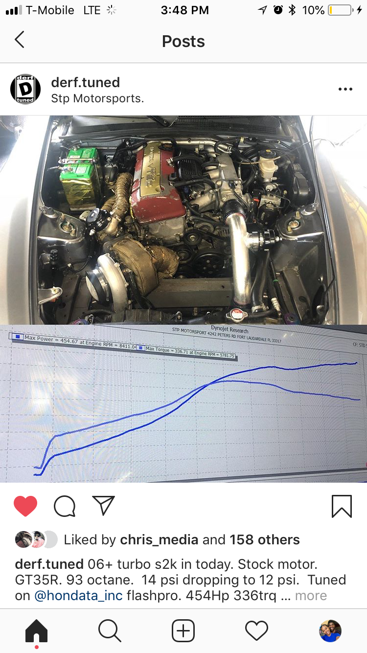

Ebay GTX3582R BB 0.63 hotside, PLM turbo Kit, 3' testpipe with a stock exhaust
Bosch 1000cc with hardwired 525 we made 454 on 14 psi falling to 12 with 93
Returnless and I think the duty was in the 70-80's (will update)
I plan to go a return style system (that was my goal but shit happens lol)
If you want 400-450 stay with 93, returnless and get a competent tuner
Anything more go E85 and to a return style.
If I wanted more power I'd go to a straight 3" exhaust, e85, 2000cc, return style but other than that I wouldn't change a thing.
