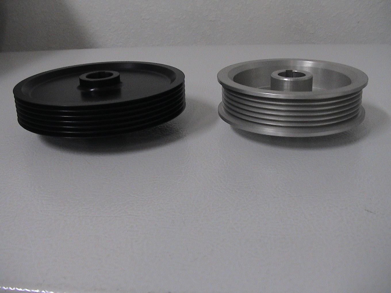

You can order a smaller pulley. I have ordered pulleys in the following sizes from various manufacturers and you can too: 3.2, 3.3, 3.5, 3.55, 3.6, 3.7, 3.8, 3.9, 4.0, 4.2, 4.3, 4.4, and 4.5 inches. The digital lathes and machines the manufacturers work with just spit them out.
Machined finish Reichard Racing 3.6 inch pulley.
Factory black pulley on the left, 3.7 inch ASP clear finish on the right.
I suggest the Reichard Racing pulley in the 3.6 inch configuration. They have it in stock as of last week. You may need to limit your redline but it will bring up the low and middle range noticeably with the top end being scarry.
If 3.6 is too small for your desires or maybe fuel system, then try a 3.7 inch. ASP in Texas makes a nice pulley quickly.
These pulleys are not on the web sites. At Reichard there is no production currently and only stock on hand is available. This may change in the months ahead.
Call your choice of manufacturer and tell them you want a pulley for Vortech supercharger, 6 ribs, 3.7 inches or any size.
Service is prompt and the prices are reasonable. About $105 with ASP and about $160 with Reichard Racing shipped.
