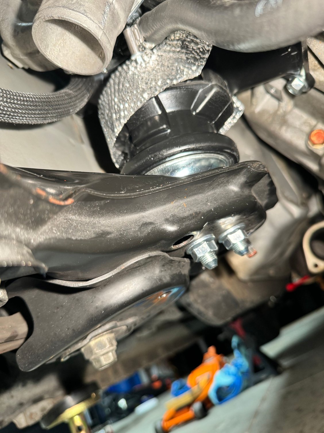

Still impatiently waiting for the new motor mounts to show up so I can wrap up the turbo install portion, then I’ll move onto adding the sensors and wiring.
I pulled out the CC bracket and removed the OEM coolant reservoir. I’ll be picking up the ballade CC relocation mount to get that out of the way.

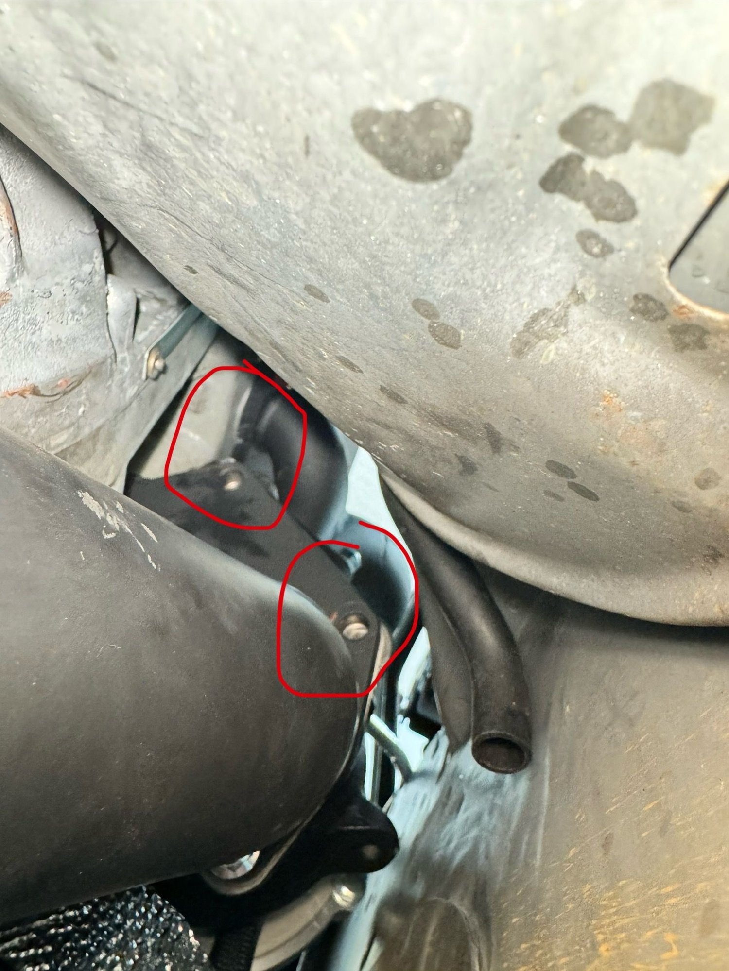

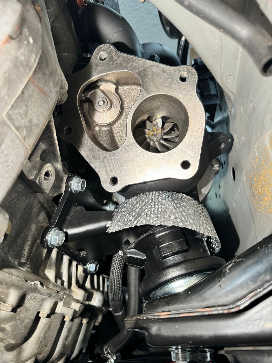

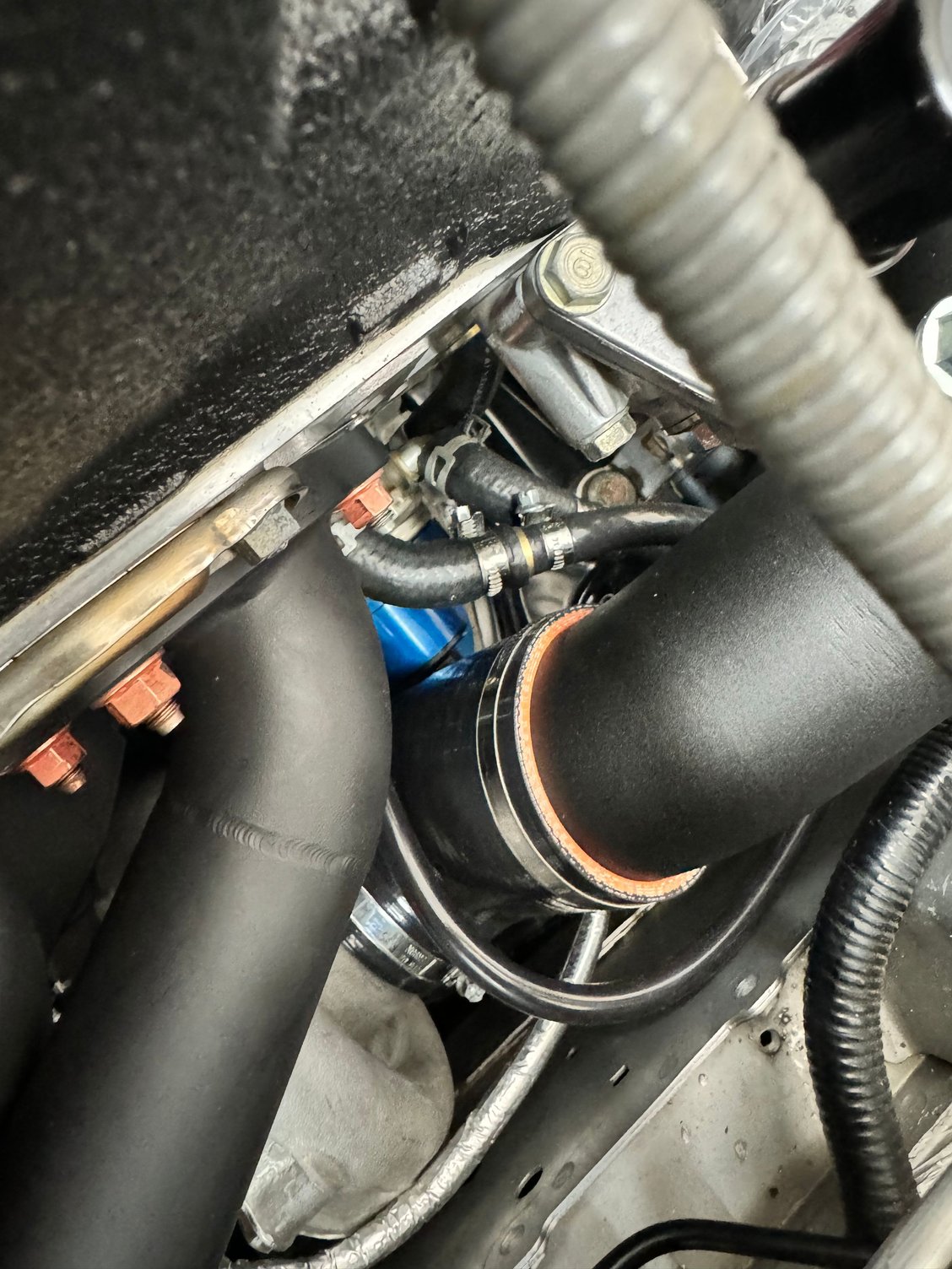

Getting the downpipe on was an absolute PITA. By far the hardest part of the job yet.
The instructions call for mounting and securing the manifold and turbo, then moving into the downpipe install.
I could not for the life of me access these 3 bolt holes.
I ended up using a long extension with flex head for the two in the first photo.
the last one is nearly impossible to reach.
I used a magnet tool to wiggle the bolt into location, then from the topside I reached a stubby ratchet box and wrench onto the bolt head purely by feel. It took me probably 3 hours to mount the downpipe.
I would suggest leaving the manifold loose and then working on the downpipe.
Also remove the cat to have more working room.

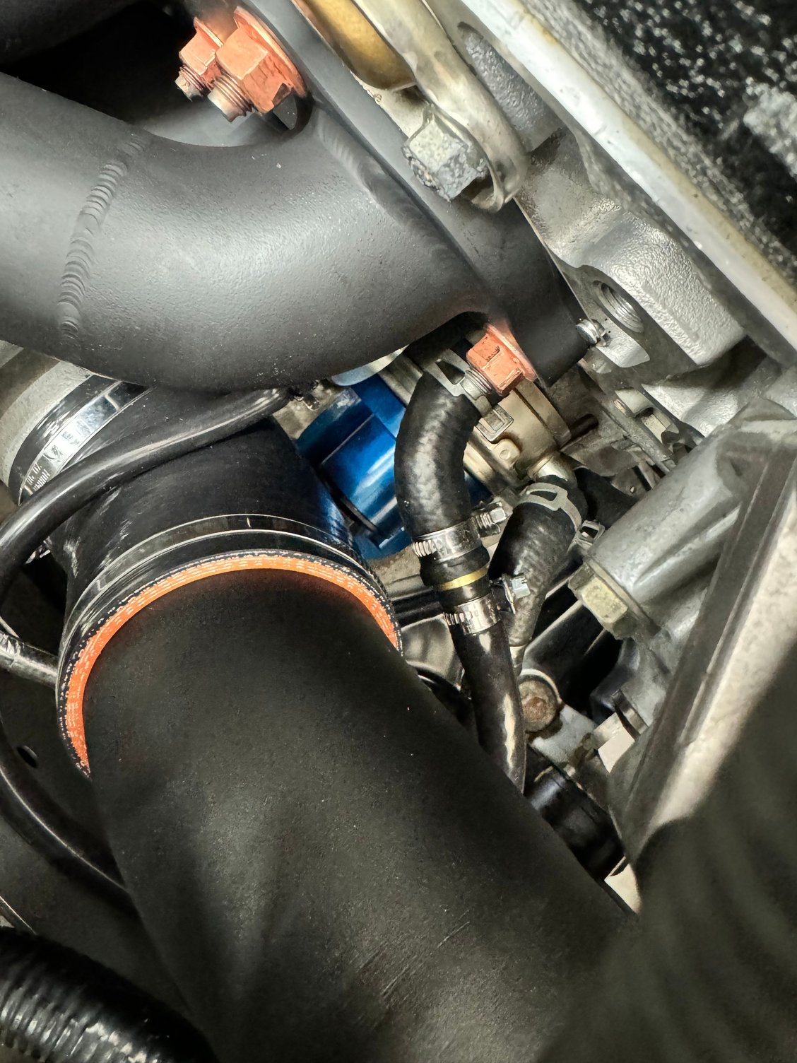

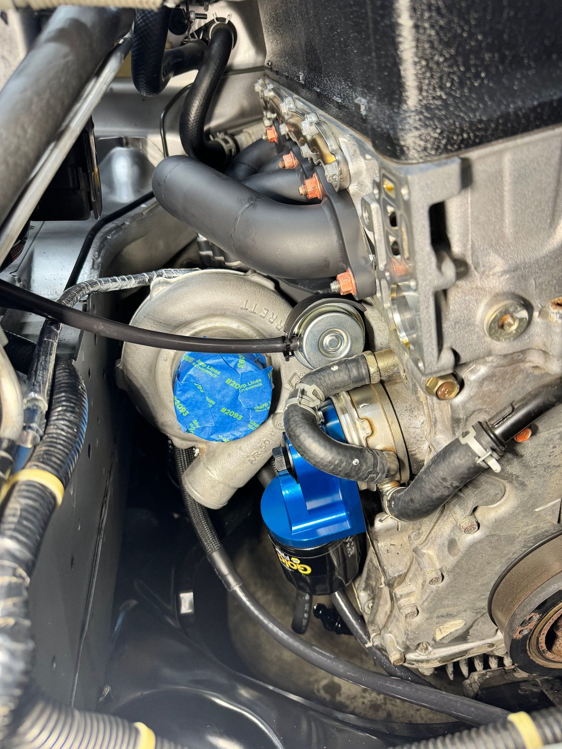

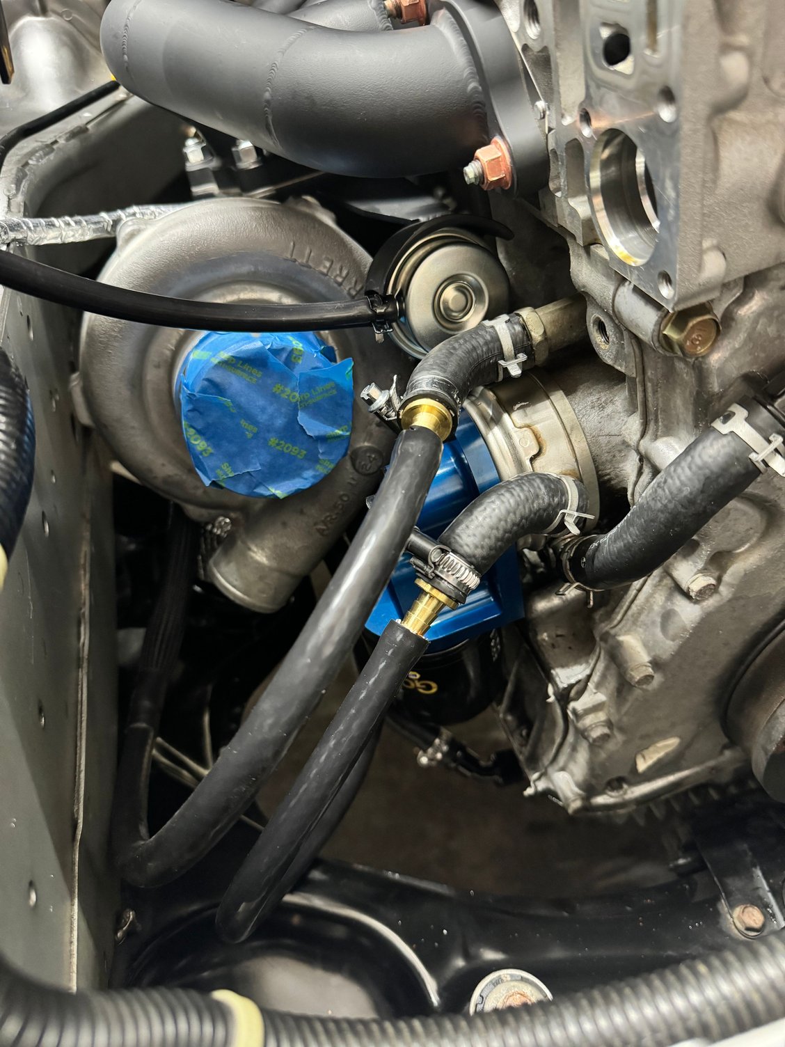

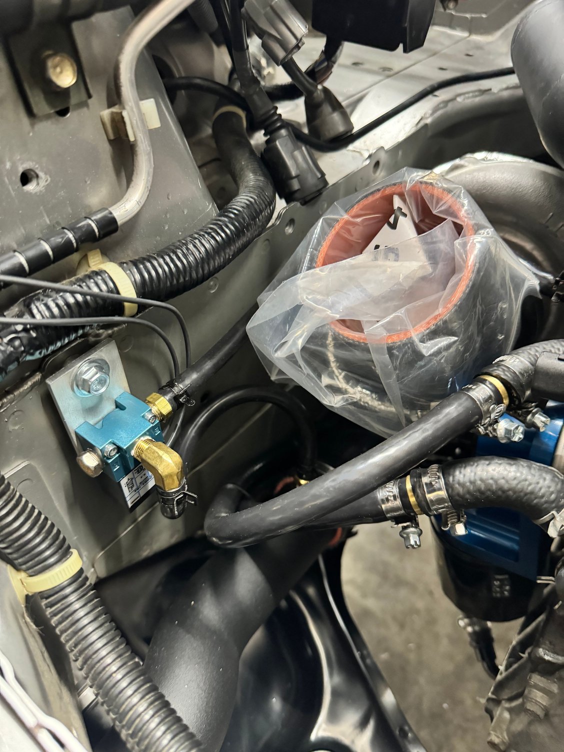

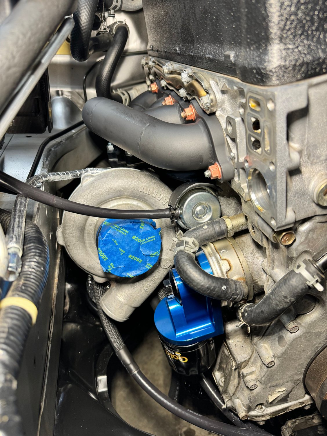

once the downpipe was done, I ran all the turbo coolant lines, oil filter relocation, oil feed, Mac boost solenoid, oil pressure/temp sensor, hot side intercooler piping, vacuum lines from the Mac solenoid, and test for the intake pipe and filter.
I will be installing the Billman TCT tomorrow and then reinstalling the vtec solenoid which will wrap up the actual turbo portion of the install.
