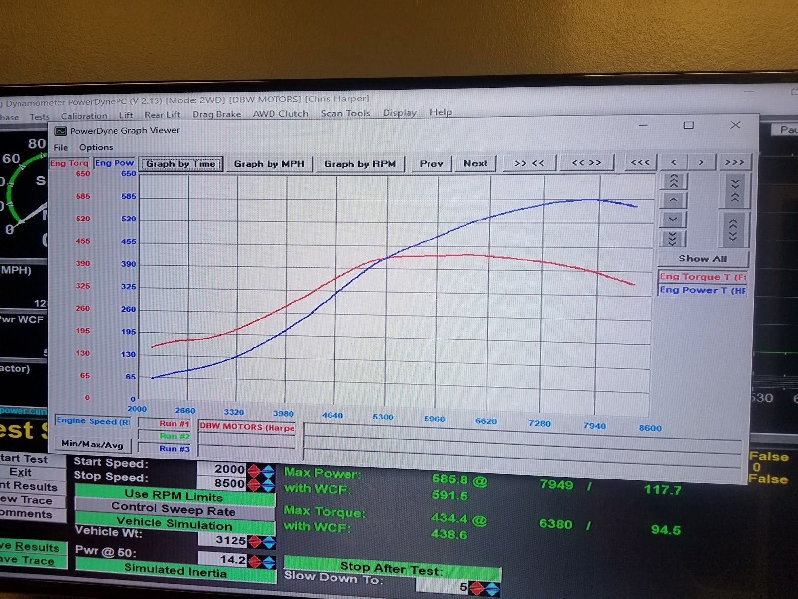

I use to have a pte 6062bb. I hated the spool time on that turbo. A borg s257sxe or a garrett gtx 3076r is definitely the choice for the power you want. The power curves will be very similar, the borg is just wayyy cheaper, its a journal bearing though. Not that it matters because it still spools stupid fast. I run the 257sxe. Fastest spooling turbo i've ever had. I make just under 600hp.
Nice looking chart lots of area under the curve.
