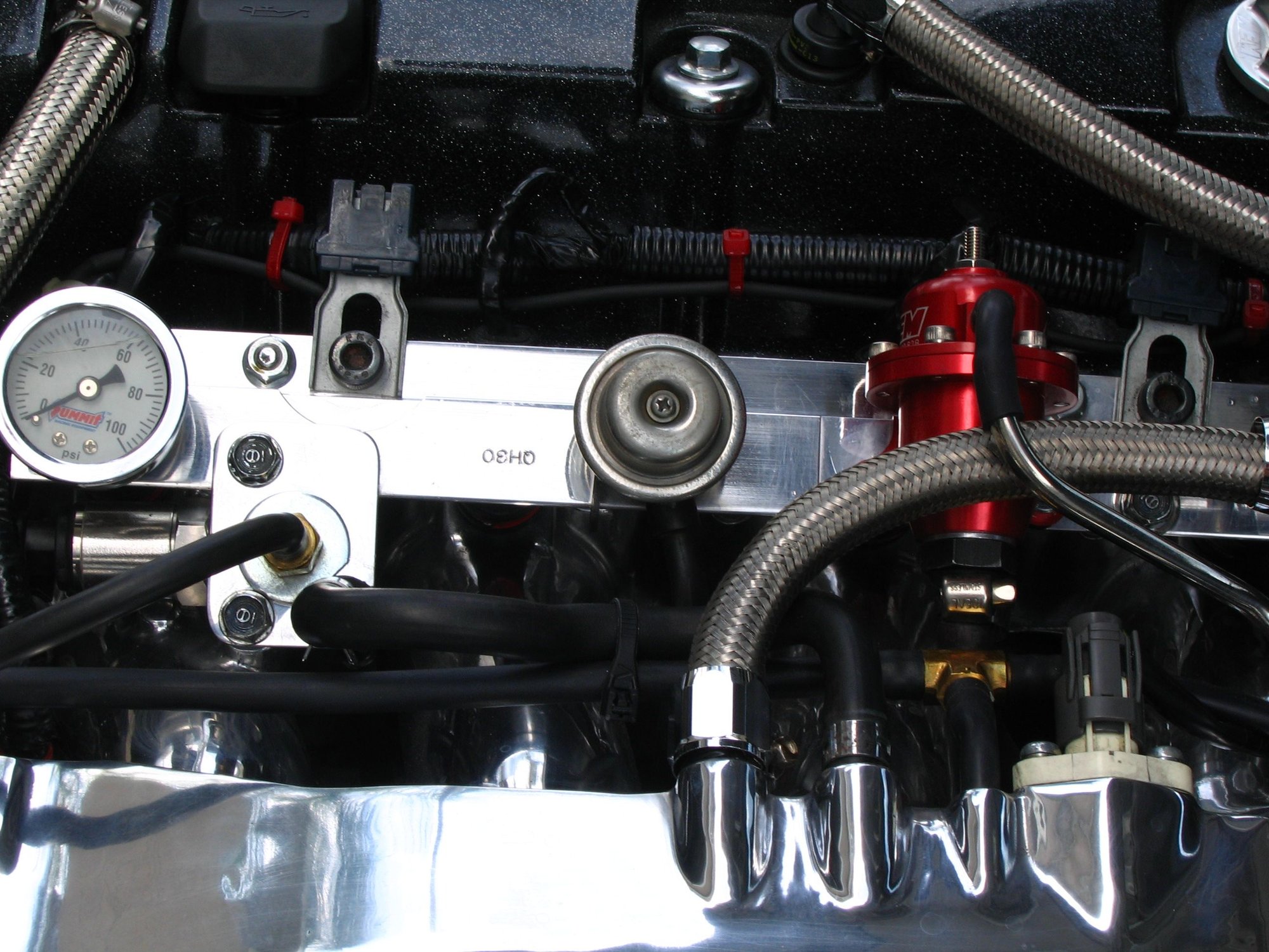

I replaced the front mounting tab for the fuel rail w/ a wider plate that i mounted the sensor to.
