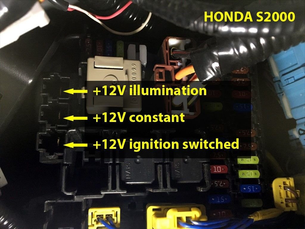

Old Feb 14, 2020 | 04:21 PM
s2000ellier's Avatar
Joined: Aug 2011
Posts: 4,220
Likes: 81
From: Florida
the top one is power when lights are on
the middle one is power always, even if the car is off without a key in it
the bottom one is power only if the key is turned to 2
this I knew. Just like I said the ignition drops power during cranking. not good for this boost gauge

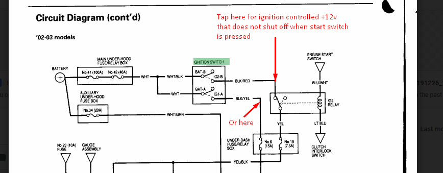

I had to do something similar for my aftermarket radio; the power cut when cranking made audio stop working sometimes.

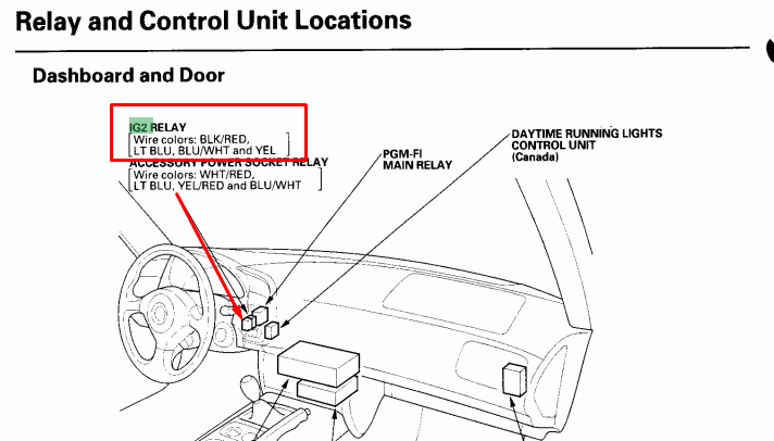

There's a relay under the dash called IG2 Relay; wired to be normally closed, it opens and cuts power to most accessories when energized by the starter switch circuit.
You can tap into the ignition power wire before this relay, tap the other ignition circuit which does not have a power cut relay, or use a fuse tap in the other ignition circuit.
Note this diagram is for a 2000-2003, newer may use different wire colors or fuse numbers.
You can tap into the Black/Red or Black/Yellow wire, or use a fuse tap on under-dash fuse #6
Make sure to use an appropriate (<= 5A) inline fuse!
Its not the easiest relay to find, use the wire colors.
