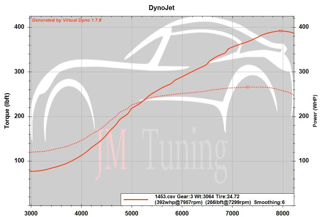

This pull below was done on the way home and thrown into VD.
This was about 13.5 / 14psi which typically youll see anywhere from 15-25HP Per psi in your typical mid frame turbo... So this is matching up VERY closely to real dyno data.
not to mention the graphs are very similar.
You also have to remember the dyno LOAD vs the real STREET load is different this will shift rpm and curve a tad... but again... its very close.
Typically I see 5-15HP error range on my VD compared to dynos, I've done this a few times, but wanted a update FI car to show you guys its pretty nice little tool.

I do use virtual dyno also and have a small question. I saw your recent graphs are between smoothing:4 and smoothing:6 . On my pulls, I saw that the gap between smoothing 1 and 6 could be from 15 to 40+whp depending on how the clean the pull is. How do you know which smoothing to use to have the more accurate graph?
By the way we can see that the real DJ Dyno is also at smoothing 5, which I did not know it would exist. I thought that a real dyno did not have to smooth the graph out...

Yes real dynos have smoothing factors too.. that's why this whole debate on "accuracy" is funny to me... every dyno calibration, ever dyno owner, depending on what smoothing they like to see ETC.. there's SOOOO many things that can change your overall power on a real dyno as well. So when dyno tuners wanna slack me for VD, I laugh. They just mad cause I didn't pay 30k for mine.
I typically use smoothing 4... seems to be a good middle ground.. unless the road was not smooth and we got bumps ill max it to 6. I have gotten some pulls in the past that where so smooth 2 even had a smooth graph lol
So just depends on data log, and if your data log is THAT bouncy that your getting high spikes, I wont use that, and get another log.
Its VERY important to have SMOOTH, FLAT, and not a WINDY day data log.
