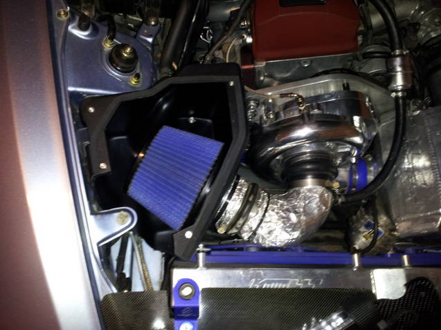

Here are the diameters to the filter that fit perfectly into the CT Icebox, the mounting is alittle off becuase I dont have the CT brackets, waiting for those to come in the mail.
5-1/2"F x 7"B x 4-3/4"T x 5"H 24-55505

here are some part numbers i found.
AFE-24-55507 5-1/2"F x 7"B x 4-3/4"T x 7"H
AFE-24-55505 5-1/2"F x 7"B x 4-3/4"T x 5"H
AFE-24-91031 5-1/2"F x 7"B x 5-1/2"T (IM) x 7"H
AFE-24-55506 5-1/2"F x 7"B x 4-3/4"T x 6"H
AFE-24-91021 5-1/2"Fx7"Bx5-1/2"T(IM)x6"H
might go with the last one..at 6" inverted top, it should fit fine right? compared to the tight fitting 7" filter.
