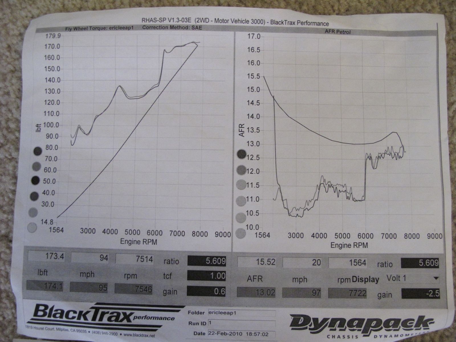

Looks like i'm having the same problem as others.
They said they tried to adjust the FPR to make it as rich as possible but it wouldn't bring the AFR into acceptable levels. After about 5K it will go too lean.
I'm at stock boost with an aftercooler and Comptech exhaust. Should I look into getting a new fuel pump?
http://www.scienceofspeed.com/products/eng...s/S2000/Walbro/
Is this the one that comes with the Comptech kit? What is a good one to get?
This was the first time I dyno'd the car after after many track events so apparently i've been pushing the car hard with it like this for awhile >_<

New fuel walbro fuel pump or its possible that the voltage is dropping at the fuel pump - entirely possible due to a weak ground thus the fuel pump doesn't get enough juice/voltage and is unable to provide enough fuel when working hard.
This happened to me, i had to take wires from the battery, wire in a relay to the fuel pump and the problem went away - easy to check just use a multimeter on the fuel pump + and - connections and check the voltage it should be in the ~13.4v range.
This has happened to quite a few folk.
