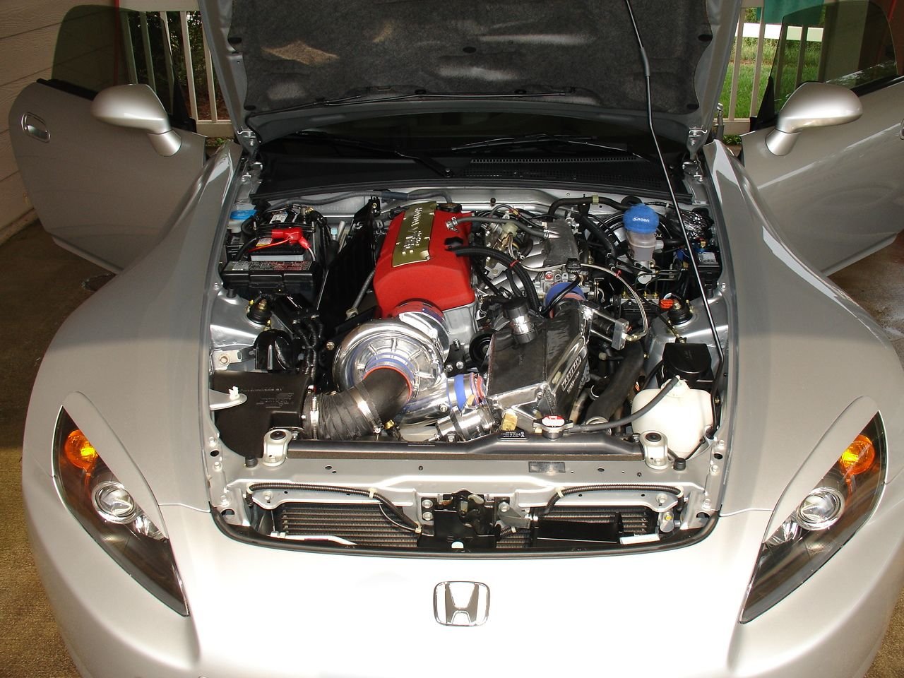

Has anyone here known anyone that has done this or done it their self. I want to upgrade the heat exchanger that comes with the Vortech kit to a much larger heat exchanger. I would assume that since it is bigger that it will cool the water more efficently and help give me a denser charge of cool air. Will i make more HP doing this or is it a waste of time and money??

Not really worth it IMO. The limiting factor appears to be the size of the heat exchanger within the aftercooler. It does look blingy though

It is a waste of time and money.

The Vortech aftercooler is amazing efficient.

Never. It's a sealed system. The only time you'd have to add coolant is if it was leaking from somewhere.

You may have an internal leak - coolant loss into air stream.
