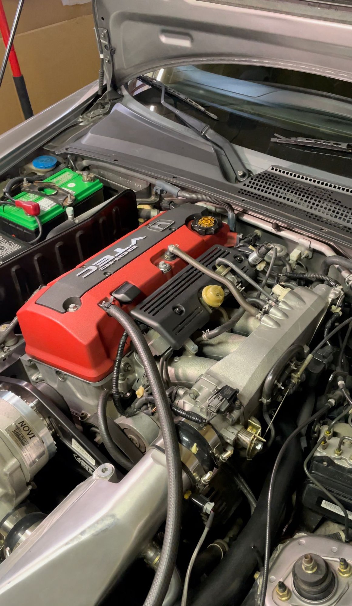

Any updates on the silicone IAT sensor with pictures? I'm looking to relocate mine and I don't want to drill a hole on the SOS after cooler.

My placement is the same as Kyle’s, but tapped into after-cooler right before the TB. It made a big difference.

I have the AEM sensor tapped into the Intercooler, having it before the TB helped dialing in the tune.
