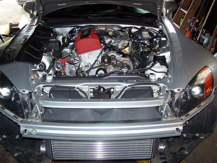

I did the install of my Greddy kit this weekend, actually just finished up about an hour ago. Overall the install is very easy and straight-forward. I started early Sat morning, and was done late Sunday afternoon. That included a few trips to the parts store, changing spark plugs, and installing a boost gauge. Also installed my sensors for the oil pressure and oil temp, but havent wired the gauges up yet. That will be next weekend along with the ACT clutch. Anyway, The car fired right up, no leaks, and runs fine. I actually havent really got a chance to feel it out yet, other then drive it around and do a few pulls through the gears just to make sure it was boosting and running properly, but it feels good. Anyway, I took a few pics along the way. Can I have that little turbo thing for my sig now?
Oh, only "problem" I have is that I can seem to get the drivers side kickpanel to go back on with the e-manage harness in there. Can anyone give me some tips?

Long black zip tie

You need to tuck the extra wires BEHIND the ECU. It's really annoying, I know.

Check Kix's build thread. He shows how he fit it pretty well.
Edit: Here you go.
