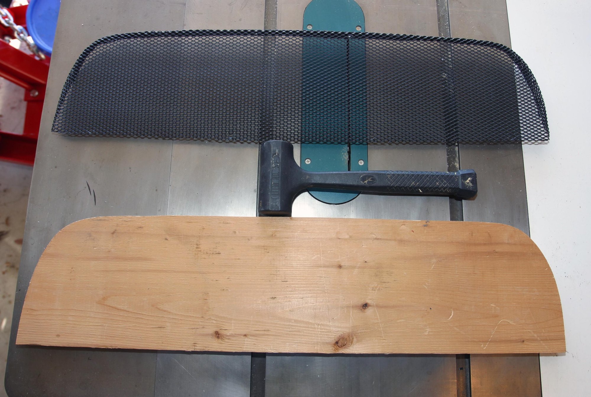

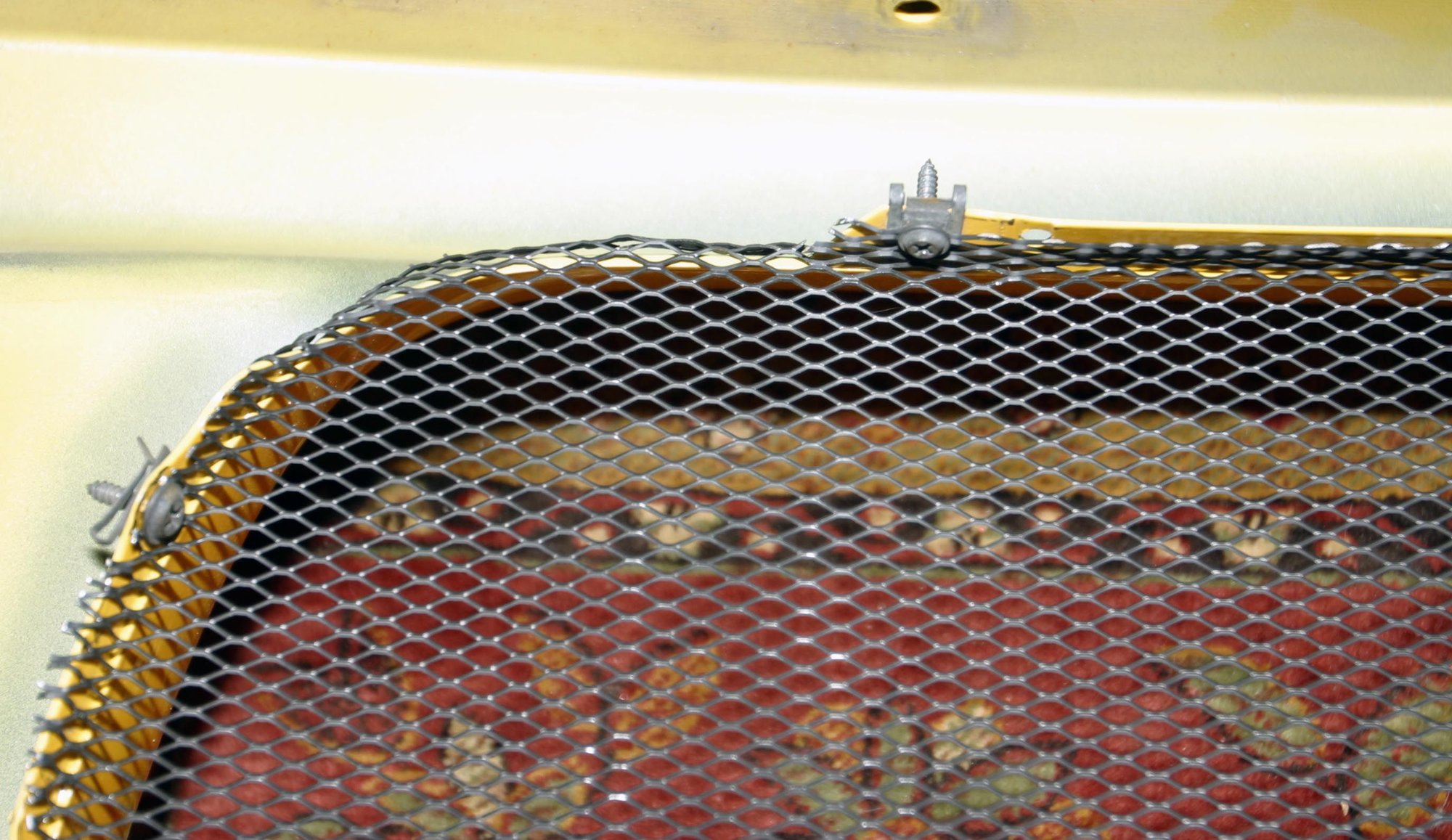

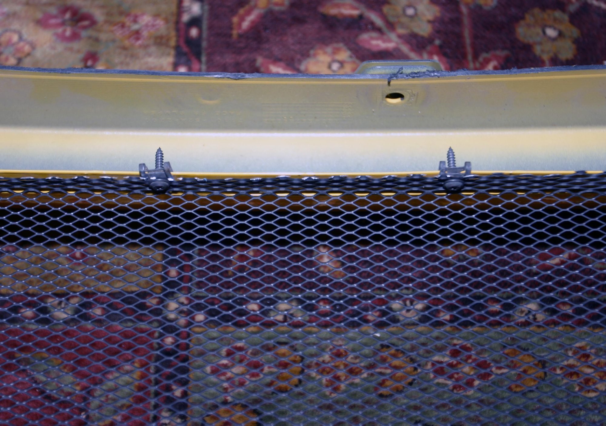

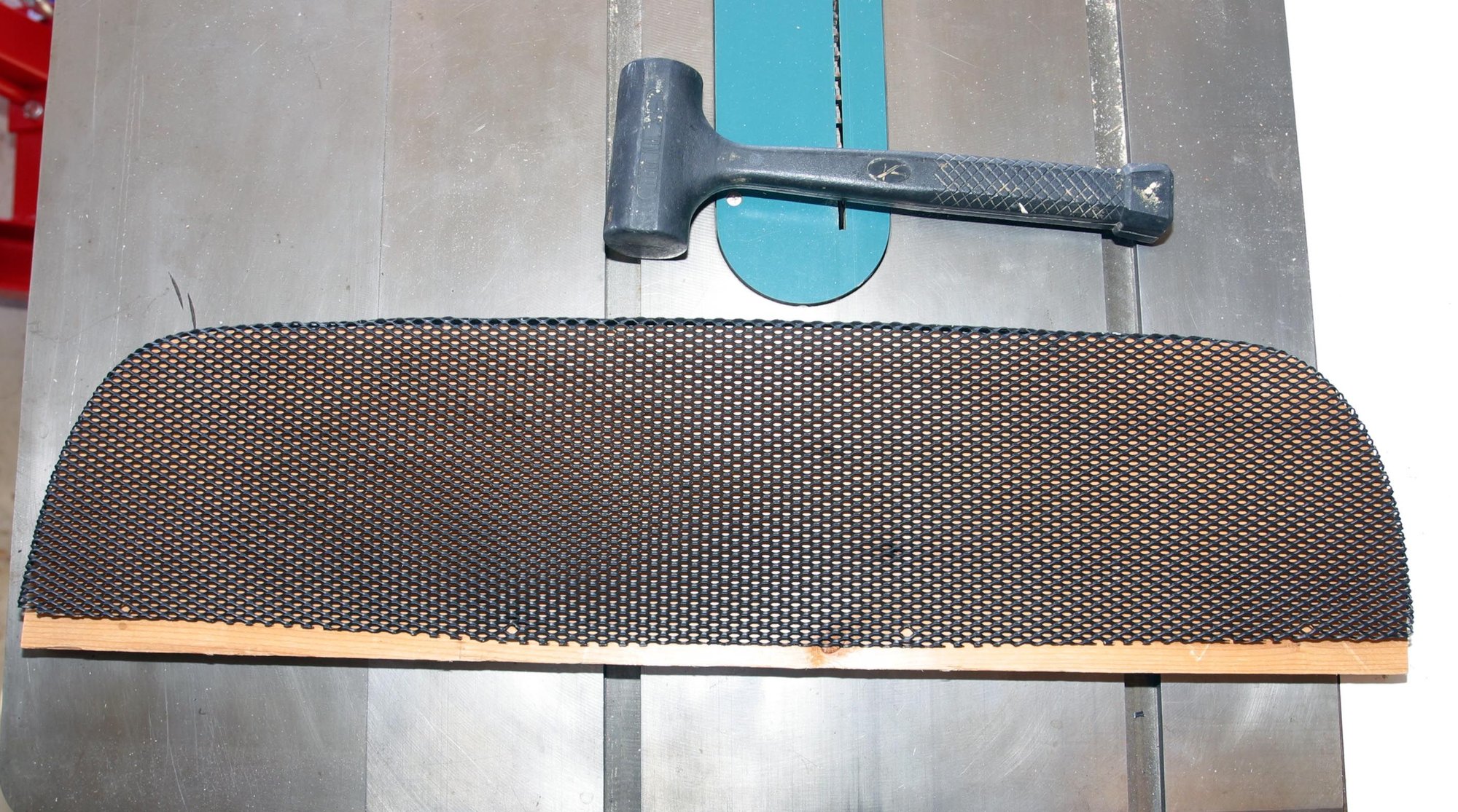

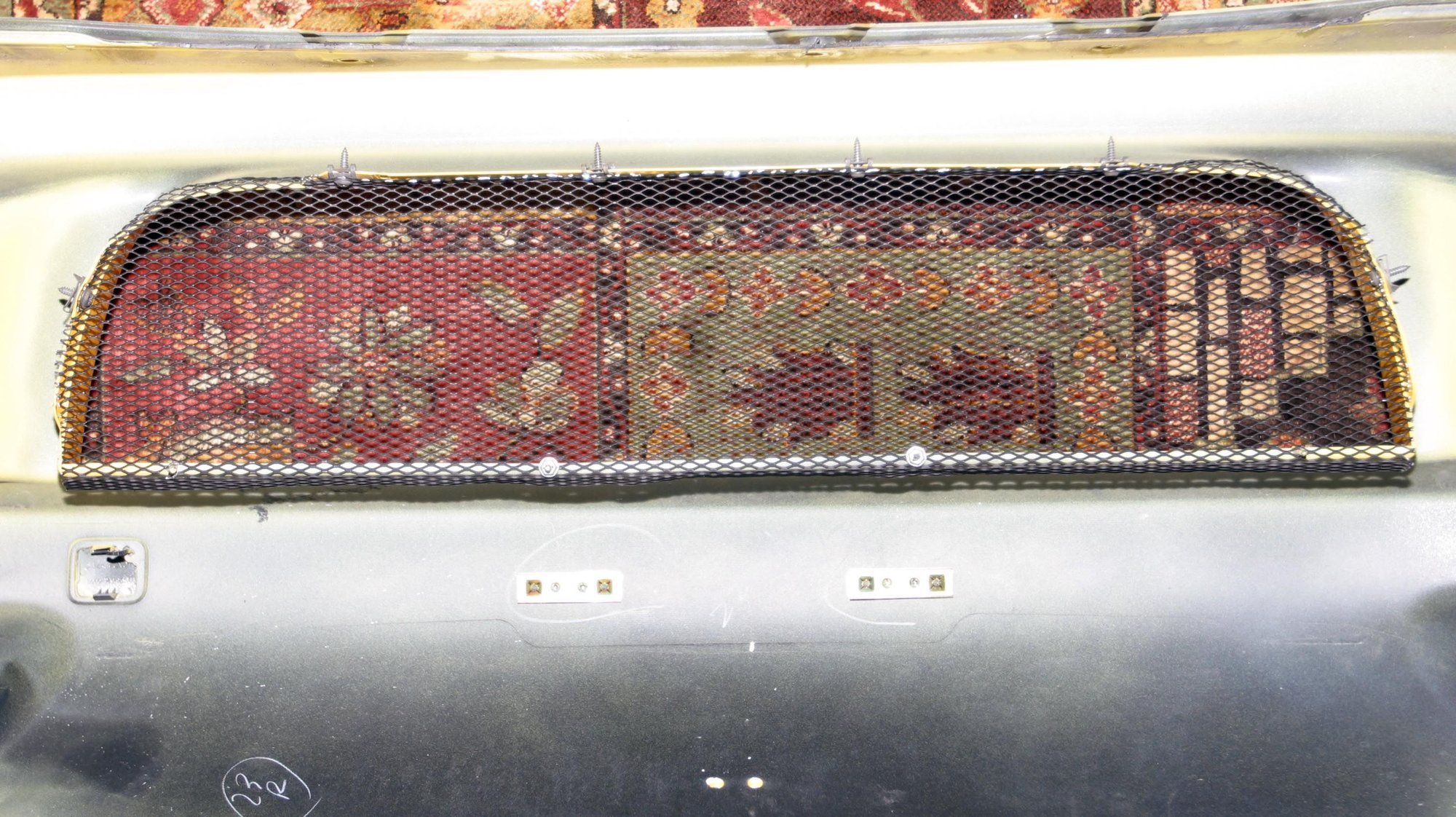

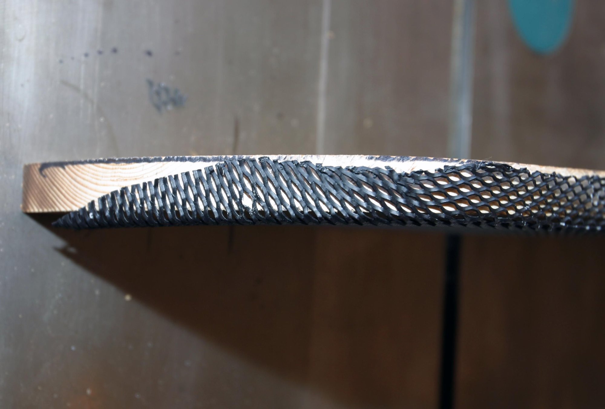

I made my own, and its fairly simple. Here are some pictures:
Old May 25, 2007 | 07:11 AM
pushin9's Avatar
Joined: Nov 2004
Posts: 2,617
From: WISCONSIN
where did you buy that mesh?
Old May 25, 2007 | 07:15 AM
fperra's Avatar
Posts: 3,178
From: Washington State
Hardware store. You can also find it on line at auto supply stores.
