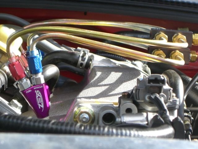

Direct Port 125 shot:
Two 10lbs tank in the trunk:
Switches:
Standalone ECU:
Dyno Graph:
Chris

Do you pill your nozzles individually or at the distribution block? And where do you get your fuel from?
Awesome set-up btw

To answer your question to SC-SUZUKA, the jetting is done at each nozzle.
Awesome set-up btw
Nozzle and distribution. Zex wants it that way. Fuel is gotten from the fuel line itself, no robbing from the fuel rail.
Chris
