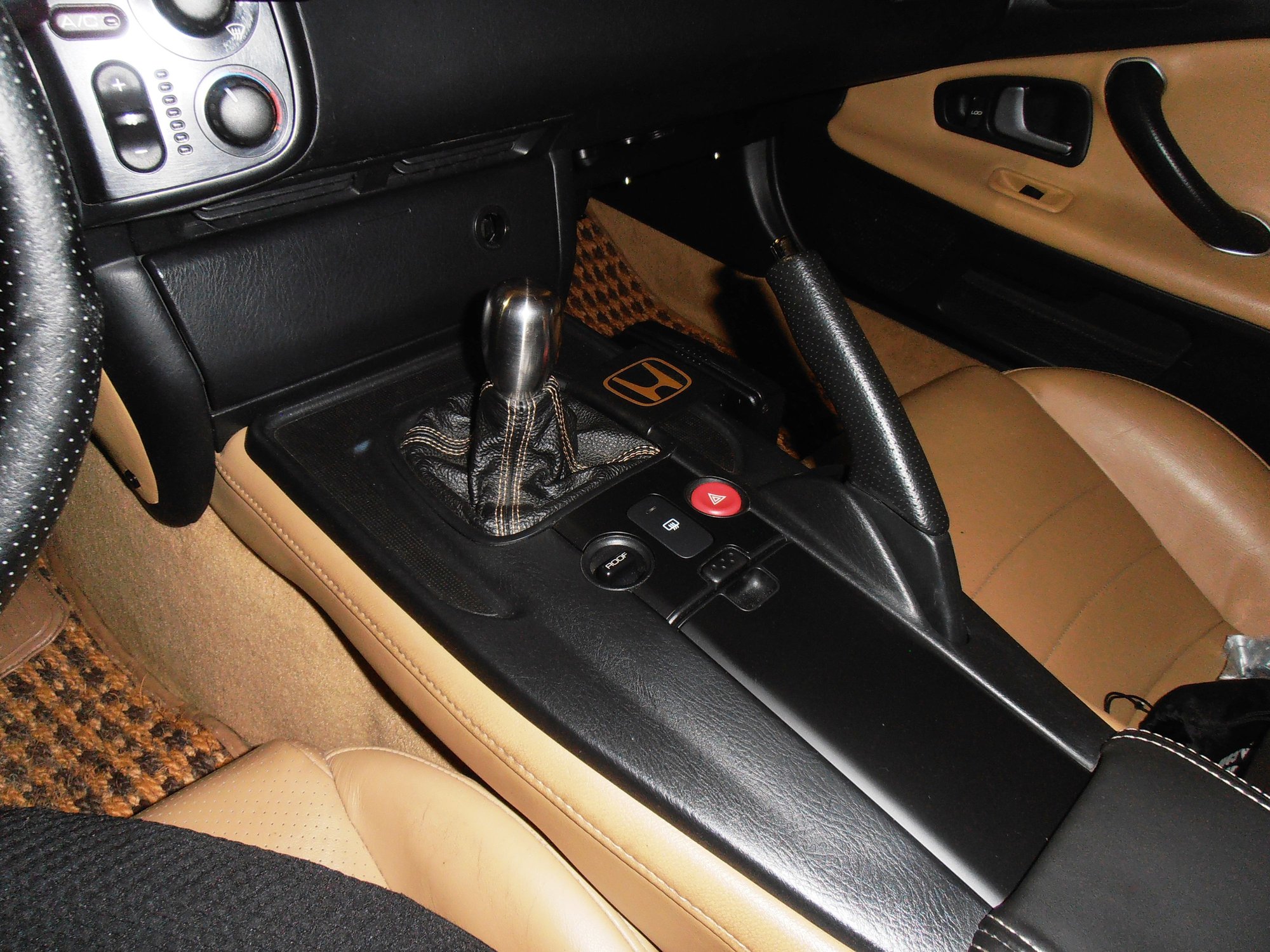

I did a full CR interior swap. The CR center console has a rear window defrost button in the center, but I already have a rear defrost button by my steering wheel....so I modified the center defrost button to become my hazard light switch. I then moved/modified my vent control knob to sit where the defrost button used to be
Attachment 88150
I put an MY08 center console into my MY04 but I converted the center defrost to my garage door opener. I just jumped the switch on the opener circuit board and screwed the opener circuit into the underside of the console.

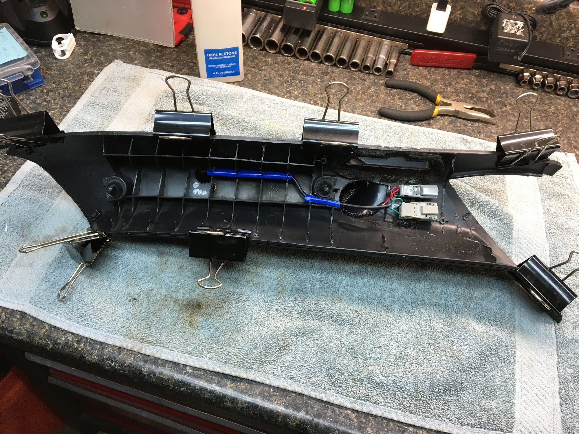

I used the Autometer unit but glued it over an oem panel that I bought from a part out. I added a pod to it for my Boost gauge. My AFR gauge is in the dash.

I used the OEM inner panel to mount the connectors for my gauge power and sensor input.
